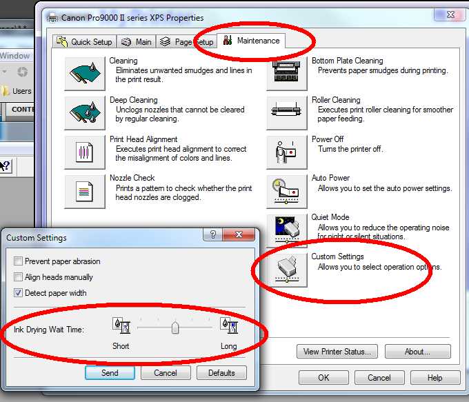

Something I've wondered about ... the 9000-2 print-driver has different selections for
Maintenance + Custom-Settings + Ink-Drying-Wait-Time.
The default is in the middle.
For a long, unattended run overnight where I expect the printer to run out of an ink color or paper, it seems like there might be an advantage to have the setting at "Long" instead of the default of in the middle. This would seem to slow down the printing so that the stacked prints would be somewhat drier on top of each other. There would be more time before the next print was stacked on top of it. Perhaps also set the Quality to High instead of Standard?
So instead of the 30+ prints taking 30 minutes, it takes 120+ minutes (guestimate). I won't be there until next morning anyway to get the "gears grinding" again.
If I'm trying to minimize the print time of perhaps 20+ while in attendance, I'll use Quality:Standard, and try to pay enough attention to keep prints from stacking on top of each other. Depending on how much room is available, I'll have 4+ stacks, and shuffle the emerging print from the printer to different stacks. I suppose it might go faster to have the "Ink Drying Wait Time" set to "Short", but I haven't played with that setting and done timings.
Ok, or do I have a flawed understanding? With glossy paper like Kirkland, is the print dry enough to not worry about them stacking up on top of each other? Seems like ... all other things being equal ... the print will have somewhat higher quality and less likely to smudge if each print gets to be on the top of a stack for 3 to 5+ minutes rather than just 1 minute.

A longer print drying time will solve the problem of ink from a previously printed picture showing up on the backside of the next print but if you don't have that problem then you don't need that solution. It already takes a very long time between prints that generally it won't matter. Where it will matter is when you are doing double-sided (duplex) printing but that is generally not the case with photo papers.
The higher quality settings are only going to actually produce higher quality photos if the normal settings have a problem caused by clogged nozzles or uneven paper motion. What they do is more passes of the print head with a smaller incremental advance of the paper. This will help mask any random clogged nozzles but otherwise the printer is not trying to actually do a better job at printing. If a printer could be made that would advance the paper by an exact amount every time and the print head could put its drops down exactly where it wanted, and if it had a sufficiently high density of nozzles, then it could produce the highest quality printout in one pass of the printhead and do it bi-directionally. But to compensate for these otherwise less than perfect capabilities, it resorts to advancing the paper by a smaller amount and overlapping the output from the print head so that any imperfections of some nozzles are masked by others.
Maybe you ought to print some photos with the different quality settings and see if there is any noticeable difference or at least a difference that is worth the extra print time.
