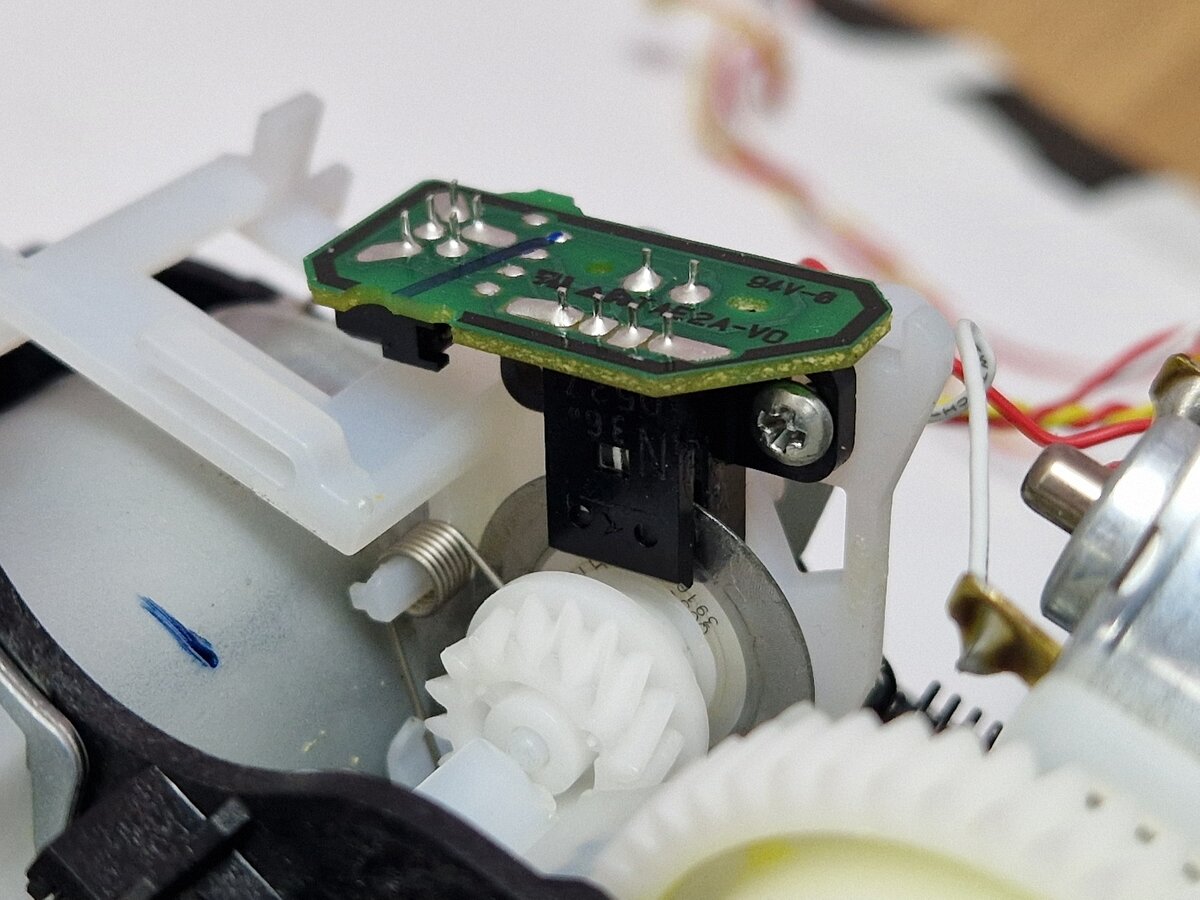

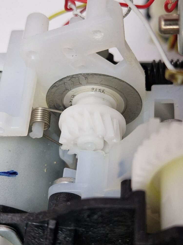

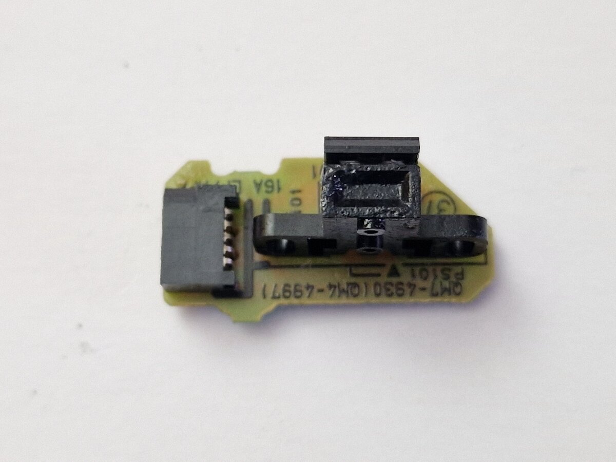

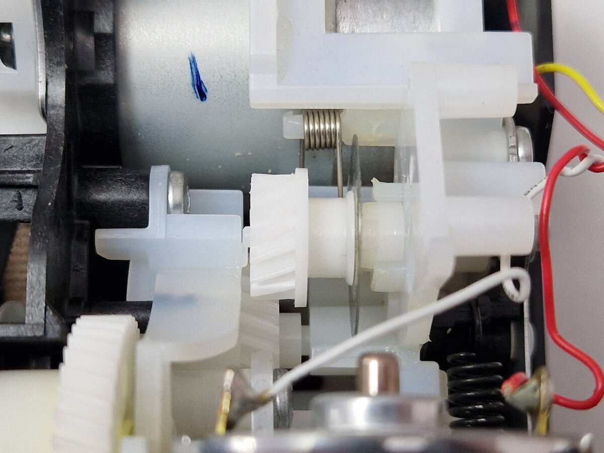

I got it. It's out! Look at where they placed that screw. Unbelievable. If it was on the opposite side, I would not need to tear the whole thing apart. I wonder how much Canon would have charged me for this. I have cleaned it up already, it looks brand new. I mean the sensor. I have not gotten to the encoder disc yet. Not sure how to get to it? I could try and clean it in situ, but it's a tiny space and I'm afraid I will only smear the grease around. But it looks like I should be able to pop that gear out with a prying tool. What do you think?

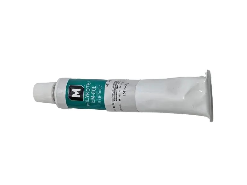

I have used a the Molykote EM-30L as a substitute for the Floil KG107A on older Canon printers. It is a white Lithium grease that is safe for plastics and contains no silicone. This might also be suitable for your printer. See this thread and this post for more about this lubricant.
Yeah, I saw your 10 year old post earlier. I know you ended up buying a small amount of EM-30L from America. I used your eBay link and landed on a search page for Molykote EM-30L. I found one company in Germany selling small tubes of it. But I looked it up and saw that EM-50L is more viscous, which is what I would prefer, because my original complaint was that the printer was noisy, so this would act more as a dampening grease than EM-30L. But I spent a good amount of time looking for that stuff and could not find it anywhere in tube or jar/pot. I even phoned the local distributor for Molykote. They only have 1 kg cans.
Both EM-30L and EM-50L are using Polyalphaolefin (PAO) as base oil, which is a type of synthetic hydrocarbon. This is the main liquid component of the grease. Its thickener is Lithium soap. The thickener is what turns the liquid base oil into a semi-solid grease consistency. It acts like a sponge, holding the oil in place. The viscosity of EM-30L is 90 cSt at 40C, compared to 1050 cSt of EM-50L.
I have been desperately searching for Molykote and Nye products for the last two months (for a different application). These specialty greases are legendary. But they don't exist in my country. We have the FUCHS group represented here that now owns Nye Lubricants, but they never heard of legendary Nyogel. I phoned them, trying to get my hands on some. It's sad how little the sales people at these big companies know about their own products and markets. I have to explain everything to them and still get nowhere. For Nye, it's easiest to order it from America. But it's much more expensive, especially now with the tarifs.

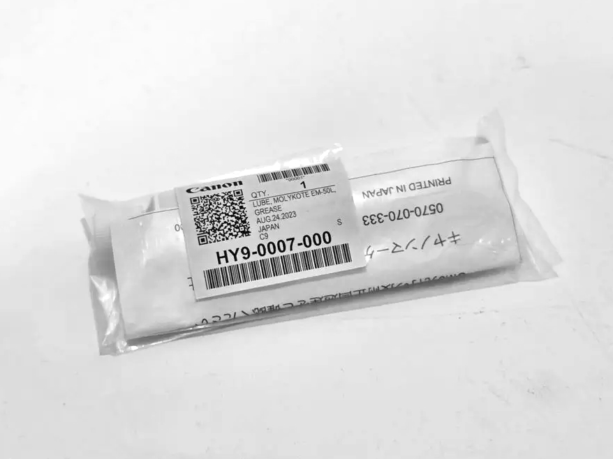

I think the only official Molykote EM-50L in tubes are specially made for Canon. They have the part number HY9-0007-000. (Other big companies may have similar arrangements.)
