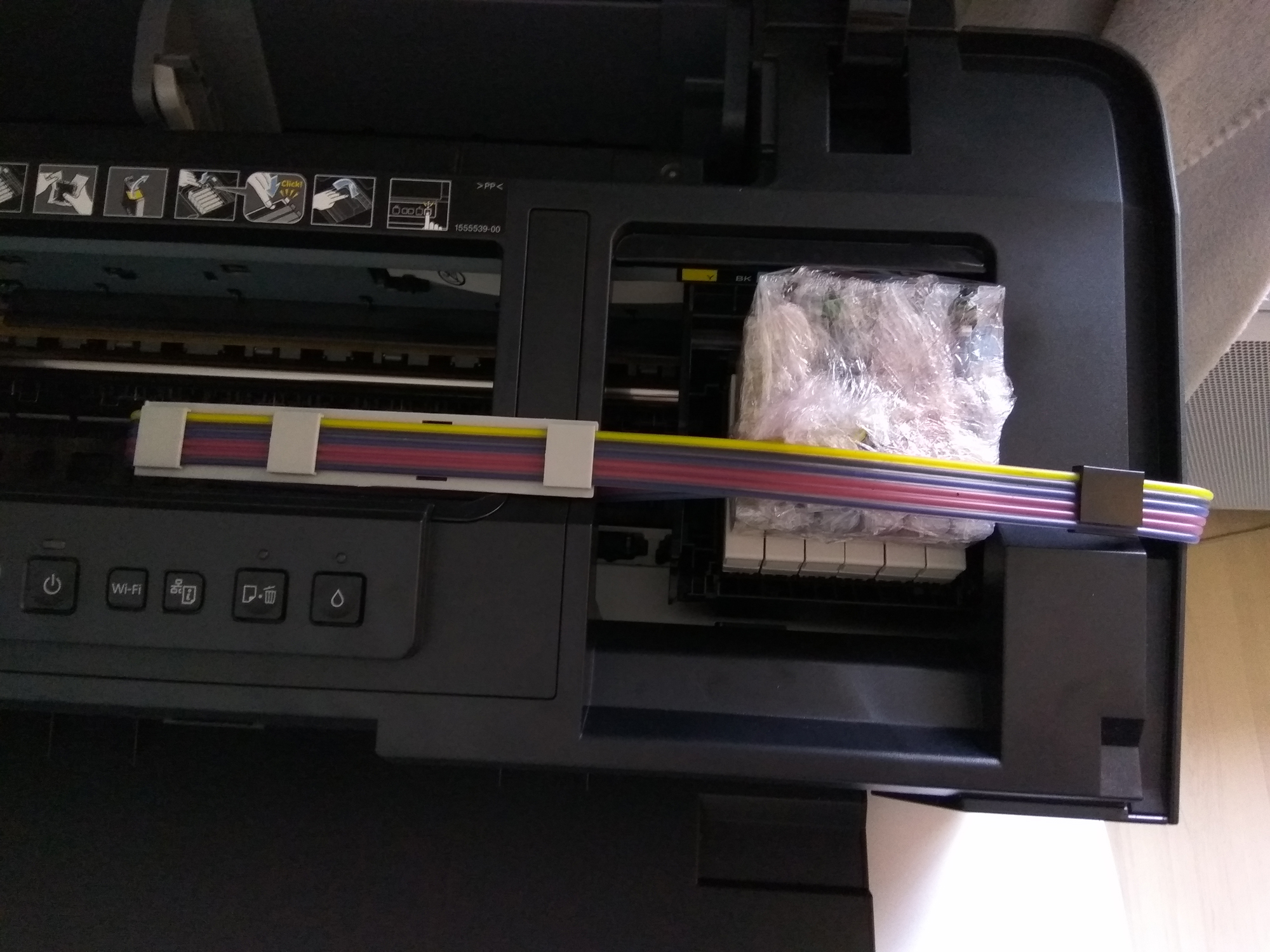

Please show us a pic of the whole setup? CISS relative to printer and some details of the kinks and bends on the install. There could be some physical issues. CISS it's great until it isn't. We've all seen this story before.

Here are a couple of pictures. Except imagine the ink cartridges being inserted and without the plastic wrap. It's just a pain in the rear end to remove them and put them back, at this point I'm just afraid to do more damage. The thing is, that it happened out of nowhere, in the middle of a printing job. I didn't make any changes to the set up before that or after. The bends in the tubes are normal without any "breaking" (If you'd like more pictures, really detailed in depth, I can take some, but at this point I'm starting to think the problem lies inside the printer itself).

But then after when I was taking pictures of the set up ( I pressed the ink changing button so I could move the printhead over to the left side so I could position the CISS as it normally is to take the picture of it) the nozzle checks gotten worse. ( I pressed the ink change button again, to bring the printhead back in place, and every time this happens, the printer does it's own "mini auto printhead cleaning" (correct me if I'm wrong?)). The ink sponge is saturated with ink and foamy? Is this because of the window cleaner? Can this be the problem?
This picture was taken before I pressed the ink change button to bring the printhead in it's good position (note: I gently pushed it back into it's position on the right before I pressed the button, I don't know if that makes any difference)

The first thing I notice is that the isobaric compartment in the reservoir is higher than the reservoir. When did it get this way? Is this your first reset with the system?
Next question does this system sit inside a room that fluctuates in temperature? The isobaric compartment is a potential clue.
You are also having color issues because you are getting colors not quite what should be there. Did you obtain profiles for this mismatched "pigment" system for a printer that uses dye ink normally.
Your problem initiated when the printer demands a higher than normal printing delivery of ink. The problem may have initiated due to air that had been pulled into the printhead from no use for a long period, and in combination with an ink level in reservoir that is low and reservoir tanks maybe too low. Or it may have come from a too high resistance of ink delivery during the clean cycle. The high resistance can create a vacuum within the CISS at the time the purge unit is pulling and when the purge unit is removed from the printhead, the negative pressure within the CISS caused the ink to recede from the nozzle. It would also be helpful to understand when this foaming occurred exactly because the ink exit system is not supposed to do that. Typically this is indicative of a restricted exit for the purge pump...like Pigment buildup in the tubes. Did you perform a lot of head cleans on this setup or has this setup sat for a long time.
Finally, if a system has been working and suddenly does not work like in your case, this has nothing to do with clogged nozzles. Nothing. Careful what you read online. You would be practicing witch doctor medicine it worked for someone therefore it must be a cure. Same for the head cleaner kit. Stop the soaking with glass cleaner now!. Keep the carts in and perform head cleans and pray that the OEM ink and the prior pigment ink can mix safely and do this until a decent nozzle check returns. If and when it does reconsider the use of the CISS.
