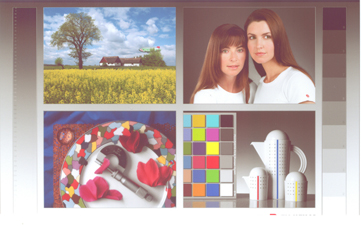

I did some other tests and printed this with
Hobbicolors
and
MIS
The difference is clear.
I tried to change only the magenta cartridge to MIS while leaving HC Cyan and Yellow, but there was almost no difference.
So I contacted Dave about this and I am waiting for his answer.
Big thanks to Osage and hpnetserver, you will both surely guide me into my next tests.
I will post soon about Dave's reply.
Thanks!
hpnetserver
Jul 8, 2005
311
119
Well, you swapped magenta and it made no difference. Did you try to swap cyan and yellow? You can find out quickly which one is causing the difference. Your MIS print looks too blue. The black on the HC print looks washed out., both look problematic to me. I don't see a green tint on the HC print. It's definitely not green. Try to sawp cartridges. It will quickly tell you what is going on. Ip3000 prints black by spraying all CMY ink. if you swaped magenta and it made no difference then the magenta ink is not the color causing the problem. Magenta is respoible for green. You do not have a green problem. Your problem is either in cyan or in yellow.

If you get a greenish tint you are not getting enough magenta, or you are getting too much yellow and cyan. The chance yellow and cyan to output too much at the same time is low. It must be the magenta that is lacking. But you have swapped magenta and it made no difference. It really doesn't make sense. Are you sure the HC print looks greenish? Think about it. The chance of both headlights of your car blind out at the same time is nearly zero. But one of them blinds out is more likely. Both of your MIS and HC prints don't look right. It could be your scanner that is not getting all the colors right.
jonalava
Nov 18, 2005
48
22
Montral, Canada
I know, the scans are pretty bad. The actual prints don't really look like this. The MIS is more neutral with correct blues (not as seen in the scan) and the HC definitely has a green-yellow cast. I already contacted Dave and he asked for the file to do some tests. He will probably get back to me soon.
The more I do tests about this problem, the less sense it makes.
Anyway, I will wait for Dave's answer.
Thanks for your help!
