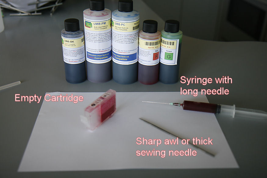

got to agree, german refill method with squeeze bottles is so quick and easy. i still refill w gloves and over something just in case. can pretty much refill/reset all 5 of my ink carts in less time than the print head moves back.
been using the german method for nearly 4 years, over 215 refilled ink carts, almost take it for granted each time i refill.
have set up 3 others who are happily refilling and printing away. some learning curve issues initially but now they are pros and also can't believe how easy it is.

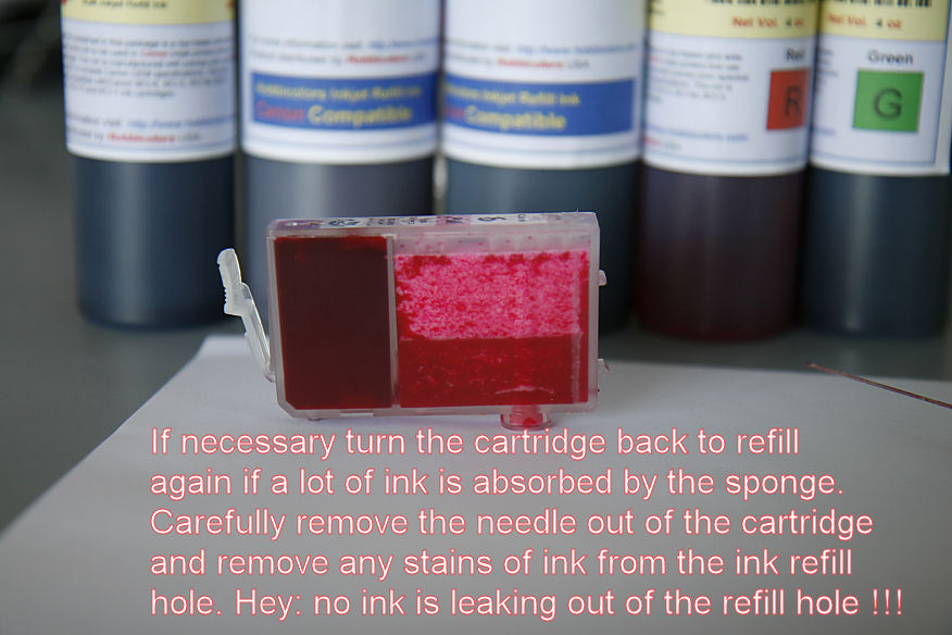

Hi Pharmacist,
I'm a bit confused here. In photo # 5 it states to keep the ink cart "horizontal" but the picture (s) clearly show it is tilted about 20 degrees downward. Was this just for the photo to show it better? Or should it actually be horizontal?
