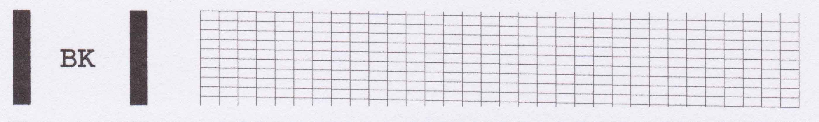

This is a BK nozzle test on a PG-510 cartridge refilled a few times with InkTec ink and method. ~100ml of InkTec ink went through this cartridge.
[url]http://www.nifty-stuff.com/forum/uploads/thumbs/8048_img_0003_copy.jpg[/url]
100ml through a combicart and still looking good. Looks a lot sharper also than the black from my MP610's semipermanent head. Unfortunately the nifty refill kits by Inktec are hard to come by in the Netherlands.

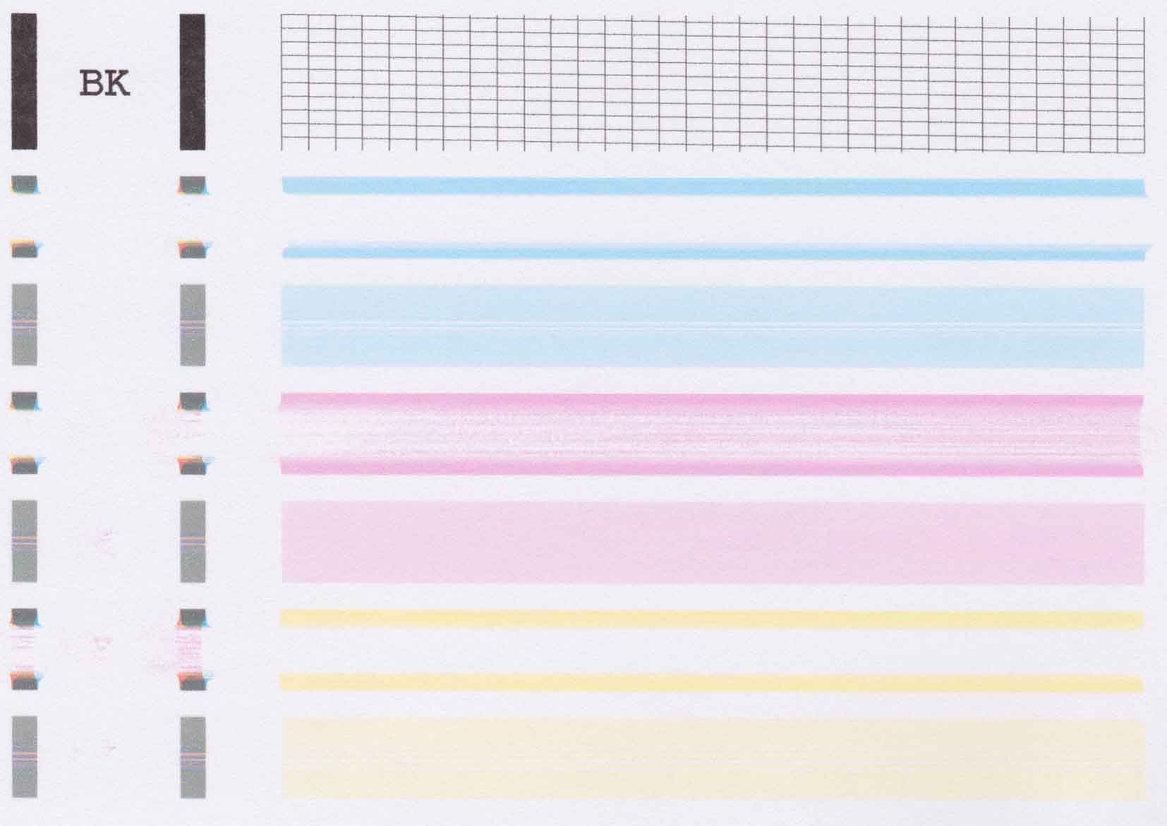

Here's the full nozzle test:
[url]http://www.nifty-stuff.com/forum/uploads/thumbs/8048_mp_250.jpg[/url]
Did you try cleaning the tricolour a couple of times? I had the same kind of weird nozzle test after my first refill. A few cleaning cycles solved the problem. Inktec has complete video tutorials on their site as well.

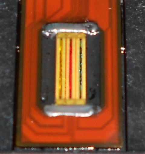

Did you notice that the cyan strip is bent to the right and the magenta to the left? Not all of the strip, just the 2/3 in the middle. That's what bothers me. The same thing happened to the previous tricolour cartridge. I doubt it's my refilling tehnique because the black is ok on the nozzle test, so it must be something wrong with the printer. I cleaned the contacts on the cartridge and in the printer (while it was disconnected from the power supply)... no change.
Anyway, the printhead is damaged and I can see it, but I don't know the cause (and stopped looking for it :p ).
This is what it looks like:
You can see it better on the magenta row (wish I could take a better photo), the nozzles seem different on the middle 2/3.
