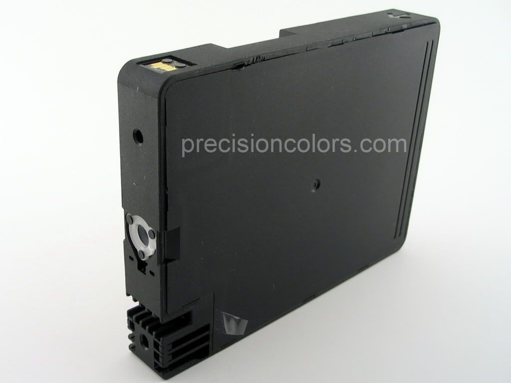

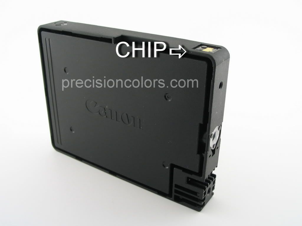

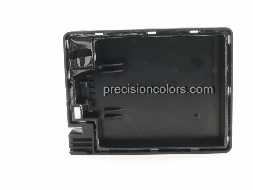

I got a couple of pro 1 cartridges just to see how easy it is to refill them.
These tanks as there now called are a big size 11 x 8.5 cm and weigh in at 81 grams with 35 ml of ink.

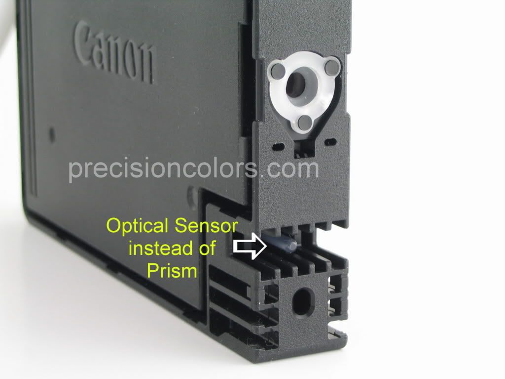

There are five holes in the back, two for what I can see are alignment holes I guess for the printer, another one has a small felt pad beside the outlet hole and the last has a clear plastic probe sticking out of it for all intensive purposes it looks like some sort of new prism system.
On the inside of these cartridges its a whole new ball game they look very like a HP cartridge that I think pharmacist done a report on it a good while ago when he was converting his printer over to using a CISS, or some other printer.
The cartridge is all black on the outside with just the one ink outlet hole on the back and a standard chip on the top.

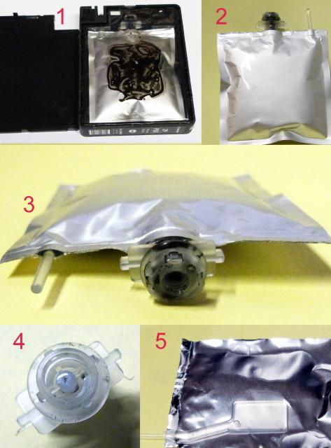

With the side cover off.

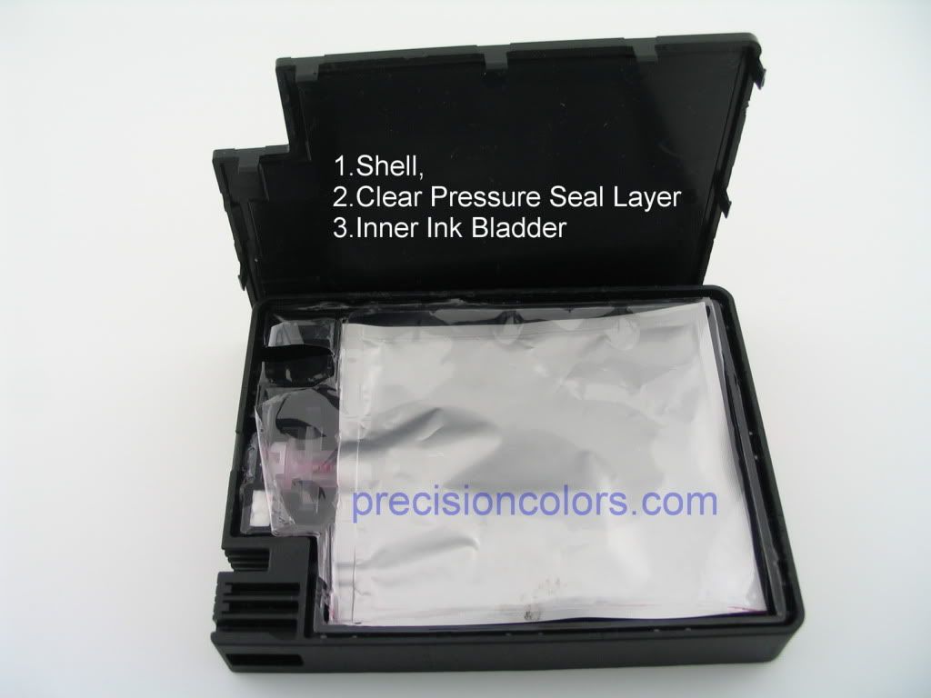

Picture 1 shows the inside of the cartridge which had a bit of a leak probably from original filling, when I cleaned the ink off there was no leaks.
There is a clear plastic film covering the inside wall of the cartridge which seals it airtight from the outside, it is not visible in this picture but it is there.

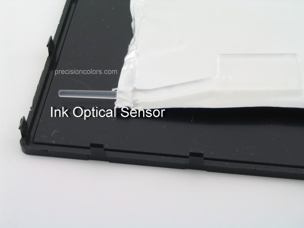

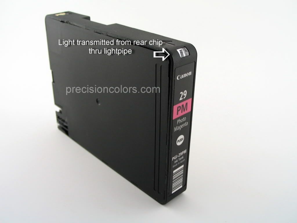

Picture 2 shows the bag removed from the cartridge and you can clearly see where the inlet valve is glued in and the prism rod sticking out the top.

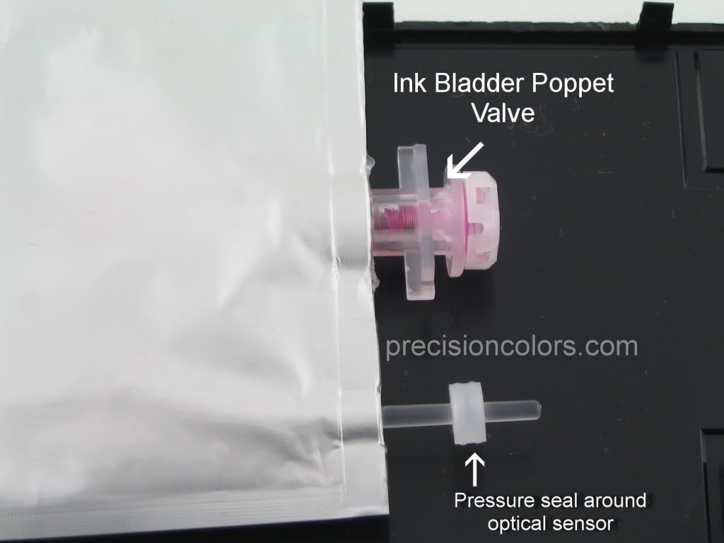

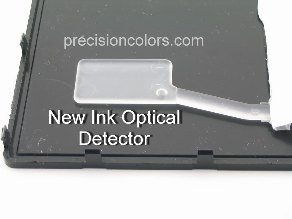

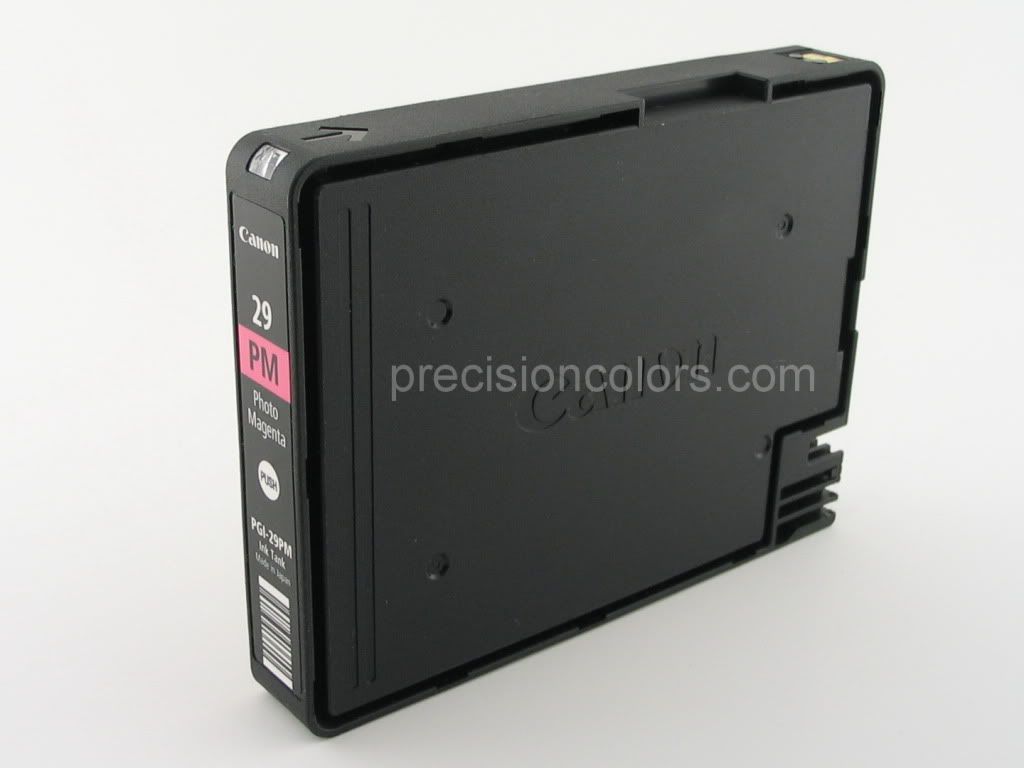

Picture 3 shows the inlet valve with the piston removed and a better shot of the new prism protruding out of the bag.

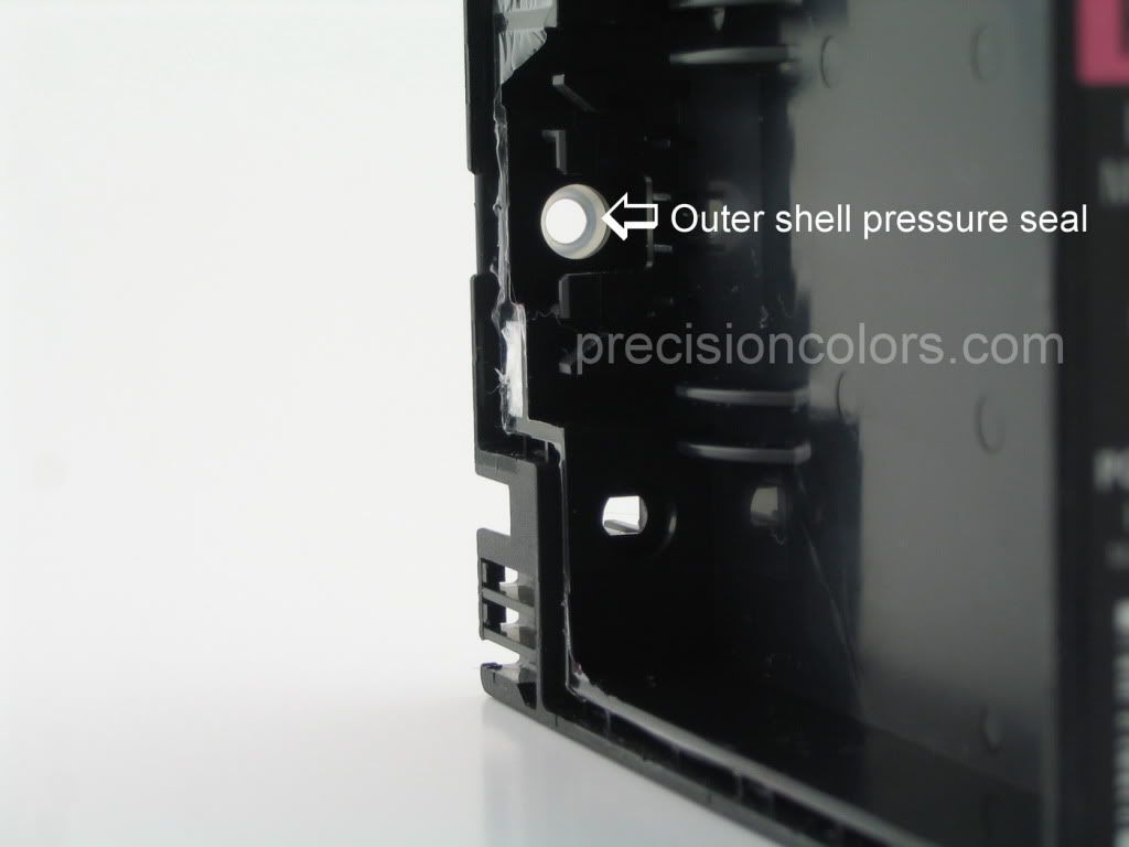

Picture 4 shows the outlet valve with the piston in place, it needs to be pressed in to allow ink to flow in or out of the bag.

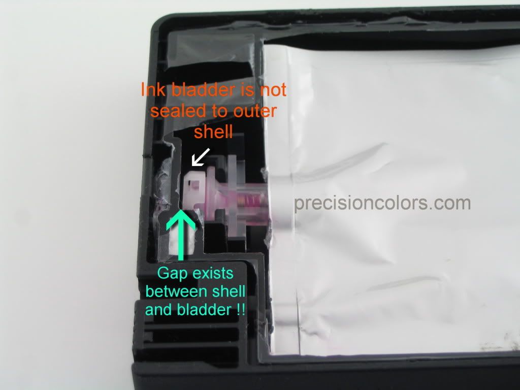

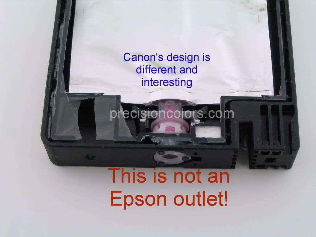

Picture 5 shows the inside of the bag with a better shot of this new prism and its shape.
There is several possible ways to defeat this new cartridge which I am working on but nothing to easy just yet, I can fill it but its darn messy.
I have not said anything about the chip on these cartridges because it will be a cold day
in hell before anybody is interested in making a resetter for it, maybe in the future an ARC will come.
The only answer for now is to disable the ink monitoring and use scales which shouldnt be that difficult.
