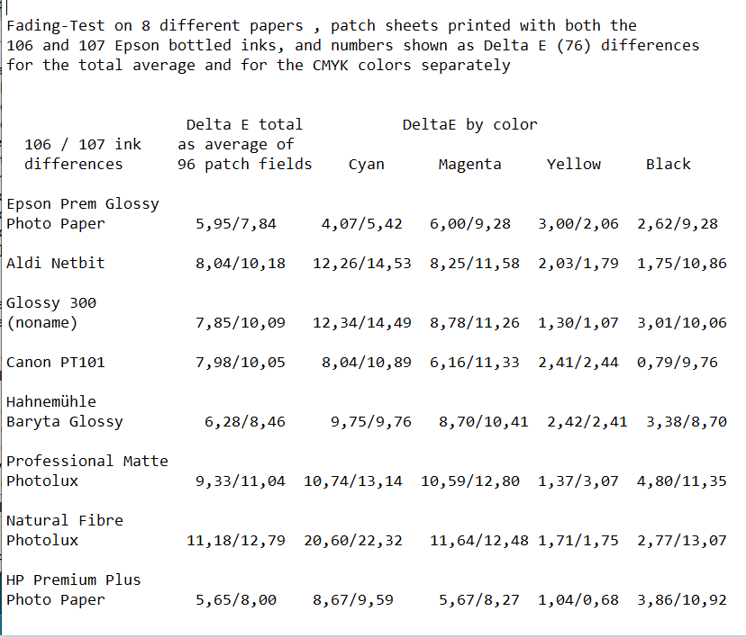

Epson has announced a new Ecotank printer ET-18100 as an Ecotank version of the older 1400/1500W A3+ photo printers, this printer comes wtih 6 inks incl. light inks like the predesessors, this printer model comes with a new inkset 107. I could do a comparative fading test of the 107 inks vs. the 106 inks of the ET-7750 which is on a market already since several years, the 106 inks are performing very well as various tests some time ago have shown. I happened to get a cartridge load of 107 ink by a member of the German Druckerchannel forum which let me do this test in comparison to the 106 inks. I'm only testing the CMYK base color inks, not the light colors, and I'm printing the patch sheets on a WF2010W which let me easily swap cartridges with all the inks for testing.
Here is the result showing the deltaE diferences of the color patches after 3 weeks exposed to the current sunny weather, the table is showing the DeltaE average of all patches, and the values for the CMYK patches individually - both for the 106 and the 107 inks as 106/107 values
The 107 inks are overall weaker than the 106 inks - except for the yellow ink which is more stable on various papers . And the table shows again the large impact of the paper type onto the overall fading stability, you cannot rate the fading of an ink w/o referring to the paper used for a particular test.

Yes - the 107 black is dissappointingly weak ; there were two intentions with this test - comparing the 107 and 106 inks and catching variances between papers - OEM glossy papers HP Epson Canon - non-OEM glossy papers and some specialty/FineArt types. The 107 inks generally turn out weaker than the 106 inks, and there is no price benefit for the 107 inks vs. the 106 inks - at least in Germany, this may vary between different business regions.

There are performance differences between the tested Epson inks, and I'm presenting some data. The 107 inks overall are pretty good, and I would not consider them a reason not to buy the printer. The test data show as well that it is not just the ink defining the fading performance but very much as well the paper you are using. And various tests have shown that OEM papers - at least those I have used - perform better than other no-name/3rd party papers.
