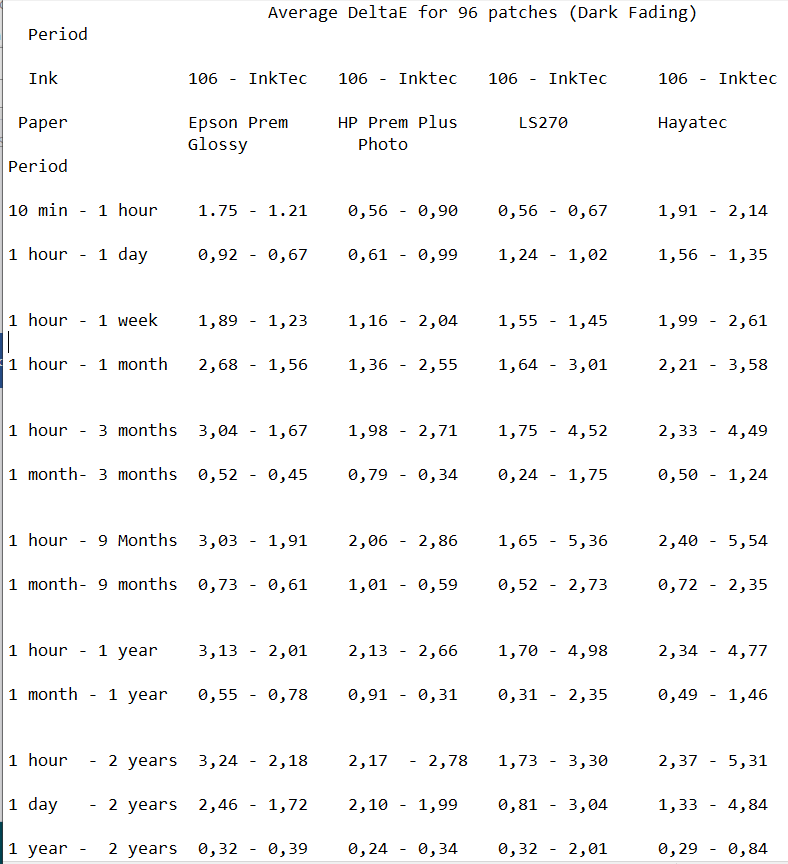

There is another varible you can look to - which color is drifting the most in these 9 months. it is in this case a saturated green which is drifting by a deltaE of 12.59, and such a drift by a saturated color is averaged away by the lighter colors which drift less - there are just less dye molecules which can change over time.

Let me update the fading results after 1 year with the patch sheets kept in the dark, but w/o any specific additional archiving precautions e.g. albums with acid free paper, special boxes or whatever. It appears to me that some ink/paper combinations are drifting slower since the last report - 9 months after print. I'm listing here the average of the color shifts of 96 patch fields after 1 hour after print to 1 year and 1 month after print to 1 year. The differences between the Epson OEM 106 ink and the InkTec ink on OEM and 3rd party papers are not very big overall but every ink/paper combination delivers a different result - it is not possible to generalize the findings overall that this or that paper or ink is always better.
I'll keep this test going, but since it is not possible to accelerate a fading test in the dark it'll take a while for more results - probably in a year.

Le me update the upper table after another year - the complete fading of patchsheets after 2 years.
It is interesting to see that the paper type very much defines whether colors shift less with the OEM 106 ink or the 3rd party InkTec inks. The amount of fading in an album or similar is defined by the paper type, and much less by the assumed long term stability of an OEM ink - in this test the Epson 106 inks. The overall fading of a long term period from 1 year to 2 years shows that inks are still drifting at a pretty low level but not zero.

It appears that for 106 and Inktec on Epson and HP paper, the average fading is almost complete after a week to a month--a month if you want to be quite persnickety. Even an hour isn't bad. I think the remaining drift over a year or two is not likely to be very visible--although I"m not sure about cyan and saturated green.
But in any case, I don't think the long-term drift should be part of profiling. It's rather difficult to determine the future appearance in a year or two, and it might not be very helpful to try to predict this with profiling.
There is one trick that you might try, however. Ansel Adams was confronted with the same problem. When he did proofs to optimize the appearance of a print, he put the prints in the microwave, to get them good and dry and display their final appearance. I wouldn't try to nuke them--just microwave them long enough to get them good and dry, and simulate that 1 week or 1 month appearance for profiling. As a big time saver it might be worth a try.
