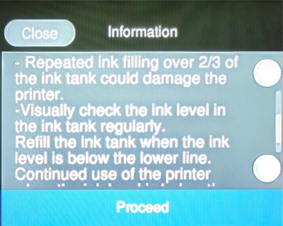

ET-8550 - Repeated ink filling over 2/3 of the ink tank could damage the printer.

I saw this mentioned on DPReview (where I don't participate) and thought huh?
So I checked and there it is:
The only thing I can think it might be talking about is that inserting the bottle always releases a little ink and doing that repeatedly could fill the tank past the normal automatic cut off level.

It is a photograph of my ET-8550 screen. Automatically presented when you open the ink tank cover.

On my ET8550 with the newest firmare OP28P8 ,i have the same information(in German), when the Ink tank cover is opend.
From my understanding, you have to wait when your ink level drops under the 2/3´s ,to fill it up(with full bottle of ink)
I think it has to do with the hydrostatic-pressure which could be to high for the dampers to fill it poperly ,or the Valve in the bottle can only close fast enough ,when some amount of ink is out of the bottle.

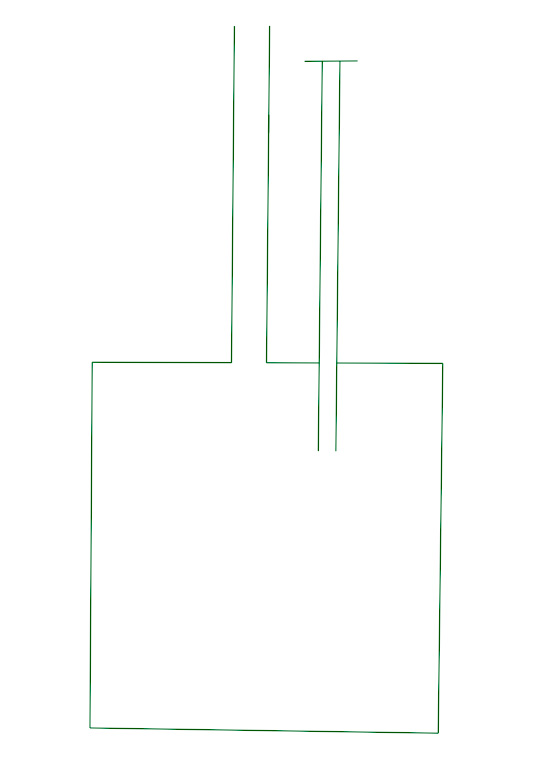

I couldn't find any good information or diagram of how the automatic level cut off works. I suspect in principle it is something like this
The filling tube is on the left and a breather tube capped with breathable film is on the right.
The bottles sort of 'glug' when filling and I suspect an amount of head is required to form an air bubble in the bottle nozzle and let more ink out. When the tank level reaches the bottom of the breather tube ink has to flow up it reducing the amount of head the bottle sees and at some point stopping the flow.
You have to put some more ink into the tank to pressurise the air in it and fill the breather tube for the flow to be cut off.
If you repeatedly stick in the bottle you will overfill the tank and if the ink reaches the breathable film it will be clogged and ruined which would be the printer damage in the warning.
The breathable film is required to let air molecules in and not let liquid molecules out so the tank can be vented without evaporating the ink.
That film would also be how you damage the printer by putting it on its side or upside down with ink in it.
