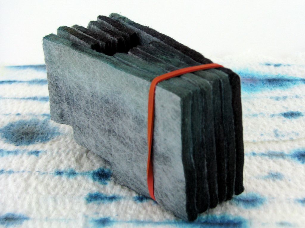

Only the hard core user needs to install an external waste ink tank on these machines. The Fact and shocking truth is that the pads are in fact Easily accessed and are WASHABLE on this machine. Removal of 6 Philips screws and the tank like cup drops out. The pads are then removed. properly rinsed, dried, fluffed a bit and then refitted into the tank tray. This is unlike most Epsons and Canons where the pads are not easily replaced or accessed requiring a waste system. So while I have shown a waste ink tank, I needed this for development purposes where many insertions and ink changes needed to take place. The average user will not undergo this unless one or more of three possible things happen. They use the wrong ink, use compatibles which do not work well or a CISS. Here you will experience "clogging" like symptoms of bad nozzle checks that jumps all over the place. If you have been through this, you now know what the problem is.
PROOF OF SIMPLICITY AS SHOWN
THE TANK
AFTER RINSING
AFTER DRYING
All the pads do is soak up the ink inside the cup/tank. Perfect fit is not necessary just make sure that a depression/hole is placed where it originally was.. You can even use female hygiene pads, baby diapers etc. if you prefer not to wash.
I will show the screws that need to be removed at another location after I get the shots clipped.
