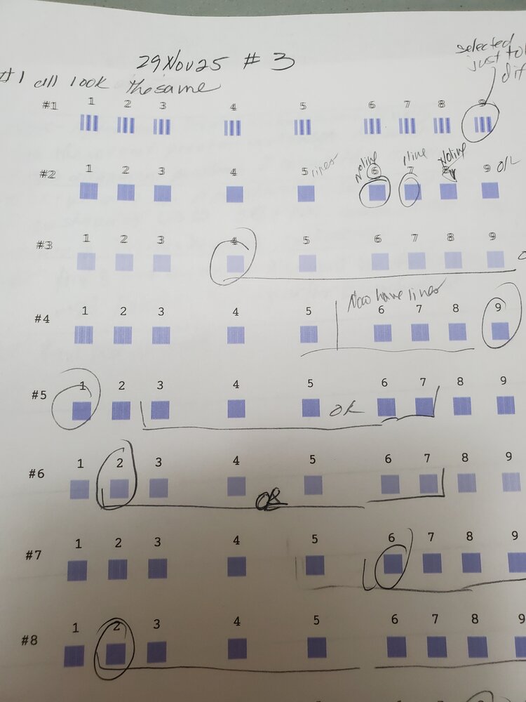

Epson P700
I have done several print head alignment sheets. The first row just never changes. It doesn't matter what number I use for the "best" square, the result is always the same and all the squares look alight.
I am in email conversation with Tech Support, and I will be doing my third round doing the print alignment. I do see changes in several rows, just not the first row.
Any suggestions?
Thanks.

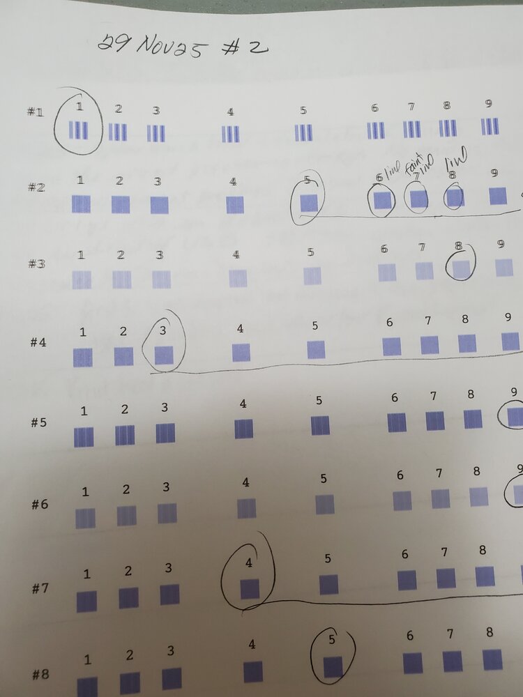

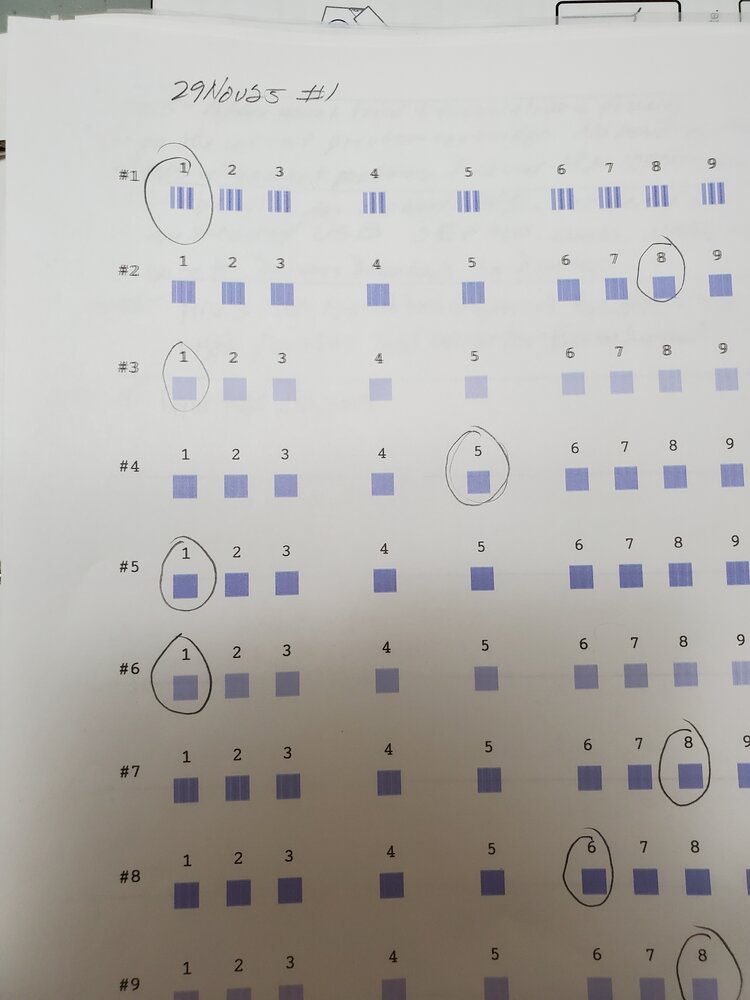

Here are the three alignments I have done today. The first row doesn't change. The other rows do change.

I have done 15 sheets of print head alignment today, and I do see improvement. But, just no change with the first row. All the numbers are now crisp. I plan to do more sheets tomorrow.
Any idea about the problem with the first row? I am checking the squares with an magnifying glass, and I see no change at all.

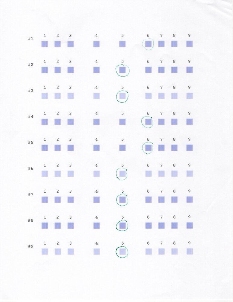

I have an Epson P900, and the pattern they use is unfortunately not the same as what you show for the P700. A bit odd since the head and mechanism are the same. I don't know if that is because we have different firmware versions or if they are just different between the P700 and the P900. I show my head alignment pattern in the attached image.
I did find one reference online indicating that, for your particular pattern, the first line does not change, and that is normal. If you were in touch with Epson support, I don't know why that wouldn't already be known.
I would like to know if you have the latest firmware on your P700. If not, you could consider upgrading unless you have a reason not to.
Also, I would suggest that you do a nozzle check to make sure there is nothing funny going on with the nozzles, causing some issue with the alignment pattern (not likely, yet worth checking)

6,361
7,580
Also, is it the goal to have all the "best" square in a specific column. I notice that you have a large number in column five.
No, there is no verification print after you enter the correction values and finish/close the alignment job.
When you start the alignment job again it starts from the uncorrected status. It just may display your last entries. So don't go into an endless iterative cycle.

Hi @Lynnea1941
Regarding the first line, I tracked it down, and unfortunately, the trail led back to your post here on PrinterKnowledge, so it's effectively incorrect.
As far as the goal, I agree with the post by @Ink stained Fingers.
I have found no information or references indicating that you should have a goal of a head alignment print with all the best boxes in a single column. Only pick the best boxes in each row, and you are done.
I took a look at the P700 service manual and did not see any better clarity there either.
Unless you are experiencing print quality issues, I would proceed with your printing projects.
