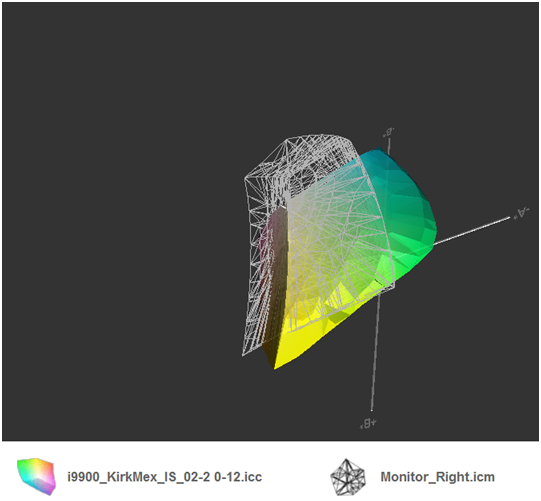

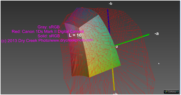

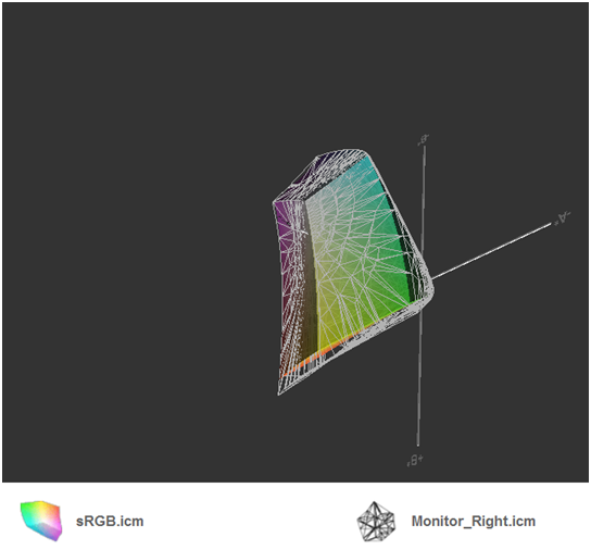

Wrapping your head around color management is not a trivial exercise. The various articles on this link will give you a cursory understanding of the subject, if you are so inclined. I have included a few screen captures to illustrate why getting your printer to match your monitor isn’t a trivial exercise. The first image shows the range of colors (aka gamut) in the sRGB color space (solid) and the range of colors that my LED monitor can display (wireframe). Note that the monitor can display more colors than the sRGB color space, but that there are some small areas where it can’t display the entire range of colors. It shouldn’t be surprising that this is the case, since the sRGB color space was initially defined to match high end monitors in 1996.
The second image shows the gamut of my i9900 (8 color inkjet) printer (solid) against the monitor (wireframe). This is why I stated previously that there are lots of colors that you can show on your monitor that can’t be printed by your printer. It also shows that there are lots of colors that can be printed, but which can’t be displayed on your monitor. In addition to getting the correct colors in the areas where the two gamuts overlap, the printer profile must also handle what to do with colors that can be shown on the monitor but which can’t be printed. That’s where rendering intents come in.
One final point – there are LOTS of colors that we can see that are outside of the range of colors available on our monitors. The last image shows the same sRGB color space (solid) compared to a high end DSLR (wireframe). That’s why many people use larger color spaces (e.g. aRGB).
