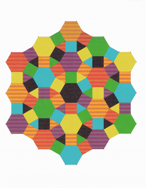

I'm running into the problem shown in uploads at 8285_cci07052011_00000.png with my IP4200. Since I'm a new user here, the system won't let me post the link inline; this is the best I can do. Basically, there are bands about the height of a line of text in what should be solid-colored areas. It's most visible in orange, red, and purple regions, but I can see a bit of it in yellow at times, and also in black. Green and blue seem unaffected.
It's using mostly new cartridges (yellow is almost due to be replaced); I believe they're original Canon cartridges, although I've occasionally used OEM in the past. I haven't refilled any of them. Nozzle check printouts look normal.
Any suggestions would be welcome.

Your description of problems with orange, red and purple suggests a problem with magenta. The banding about the height of a line of text suggests something like this: http://www.nifty-stuff.com/forum/viewtopic.php?id=6747 but with problem in magenta instead of cyan. But you say nozzle check looks normal, so I am out of ideas without pictures.

Thanks, PeterBJ. I can now post images; huzzah! Here's the picture of what I'm experiencing.

Can you force a "Service Test Print" from the printer and post that? It's typically different from a nozzle test print and provides more information.

Also post a "High Quality Print" and a "Low Quality" (draft) Print. Looks like you had posted one that was printed bi-directionally (low quality, draft). Do you see a difference in the two??

At least post a nozzle check.
It looks to me like you're going to find that PeterBJ hit the nail right on the head with this one in that one half of one of the magentas is not working and you'll probably have to get a new print head.

Happened to me too, with yellow in Pixma 4500, about a year from purchase.
It was an electric failure in printhead.
