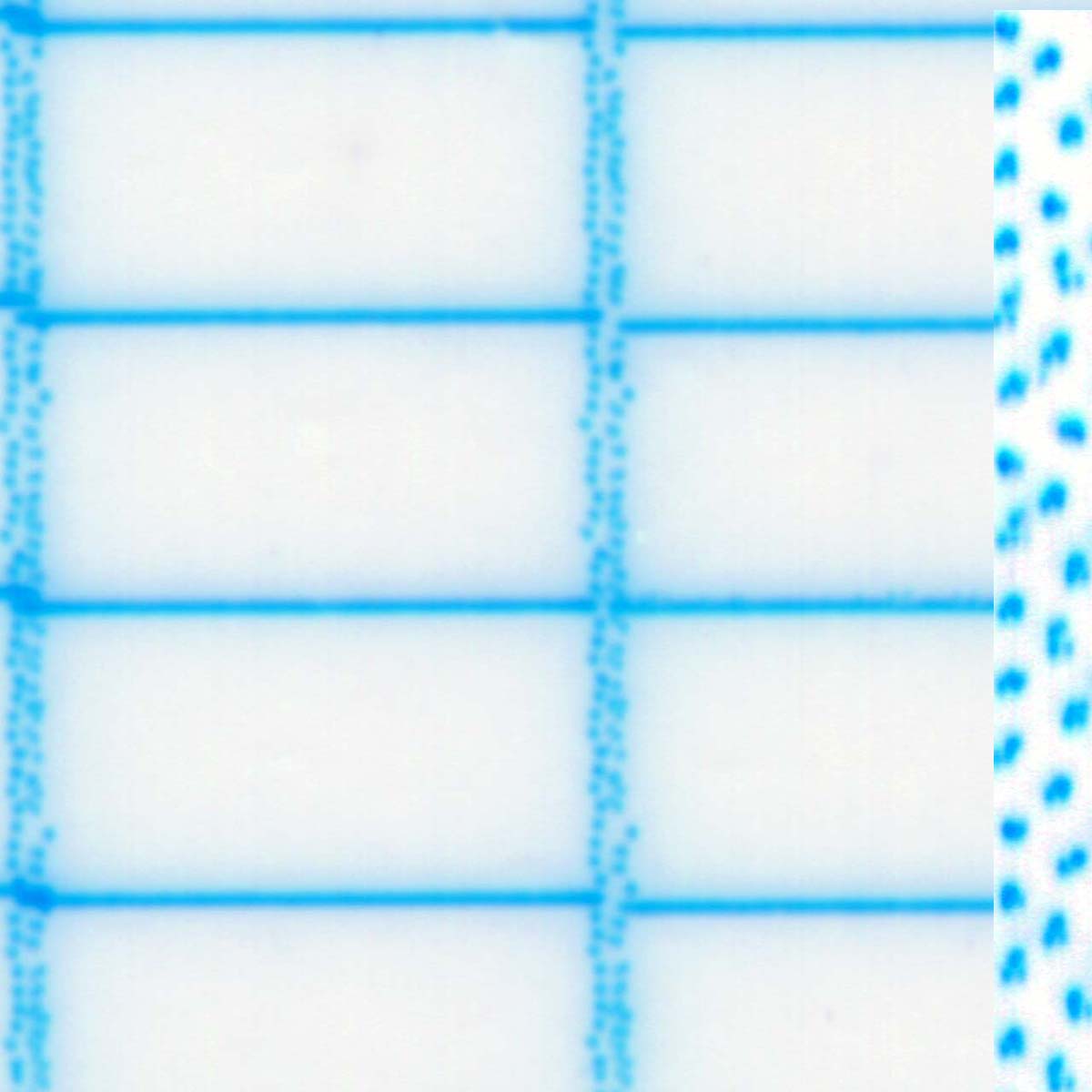

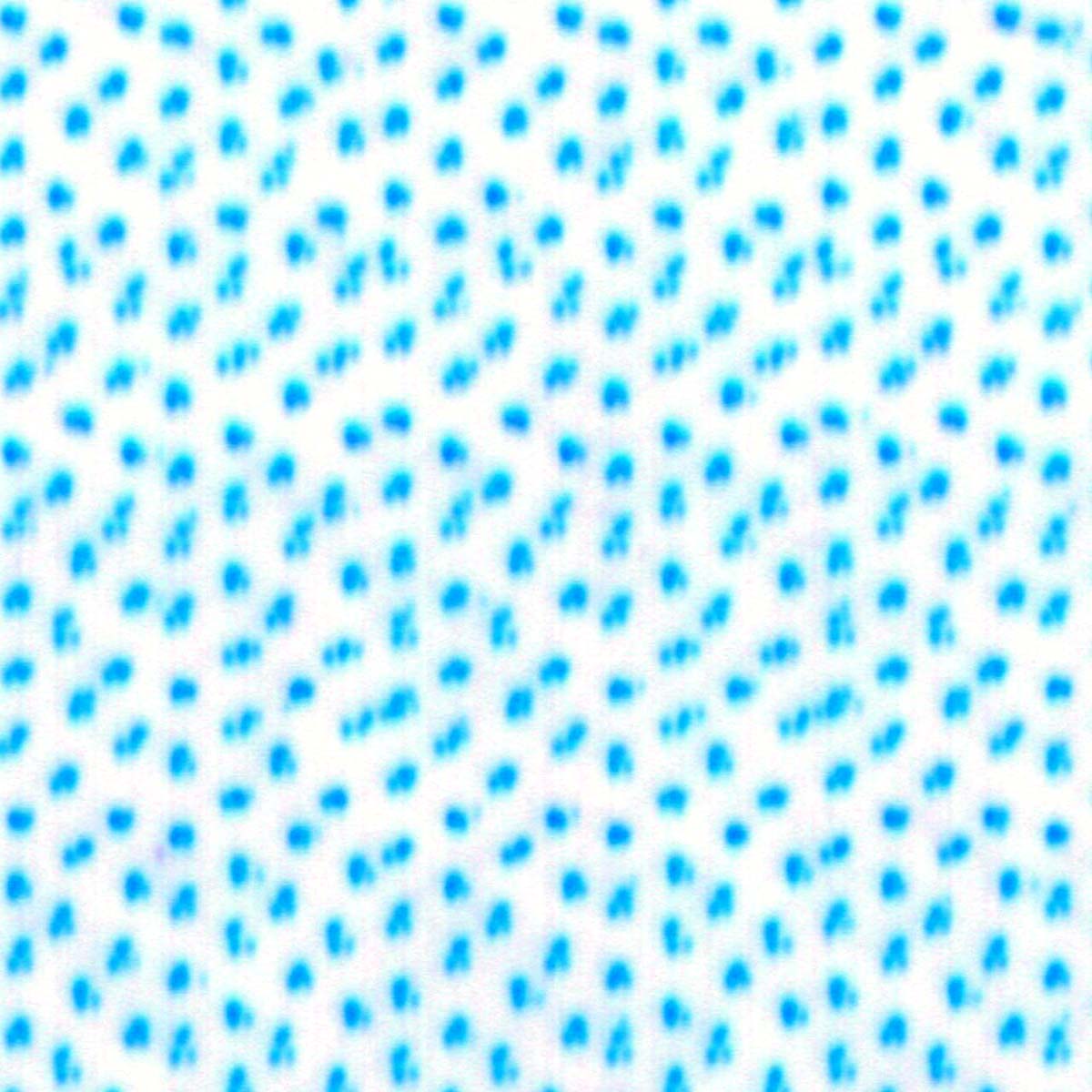

I ran some tests on my i9900 (768 nozzles, 2 columns of 384 for each color - 3x as many as the ip5000). The nozzle checks look like this:
As before, click on the thumbnail to get a larger image, then click on that image to get an even larger version (1200x1200 pixels). It looks like there are 4 individual (and approximately equally sized) ink drops in each cluster, with the spacing of the clusters being 4 nozzle spacings (4/600 inch). I don't see any evidence of extra drops in this Cyan scan (the magenta and black scans looked the same).
These images were scanned at 12800 pixels/inch, then resized to 12000 pixels/inch to get exactly 20 pixels/nozzle spacing on each image, with each image representing a 0.1 x 0.1 inch section of the print. The light "levels" were also greatly enhanced to bring out the relatively light original I opened the cover while these tests were being printed, and every nozzle check was printed from left to right.
This is a portion of the extended nozzle check, scanned at the same scale. A portion of the previous nozzle check was superimposed on the right side to make it easier to make a comparison. The horizontal bars are spaced every 32 nozzles, then every nozzle is fired (you can see 32 distinct ink dots printed in each vertical bar - 2 columns of 16).
Again, there is no evidence of extra ink dots in this area. For some strange reason, every extended nozzle check is printed from right to left - exactly the opposite of the nozzle check.
These tests were printed on Kirkland Photo paper, in case that makes a difference.

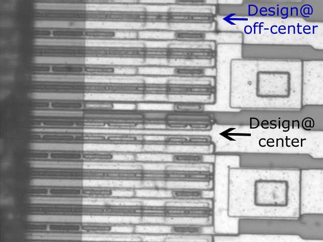

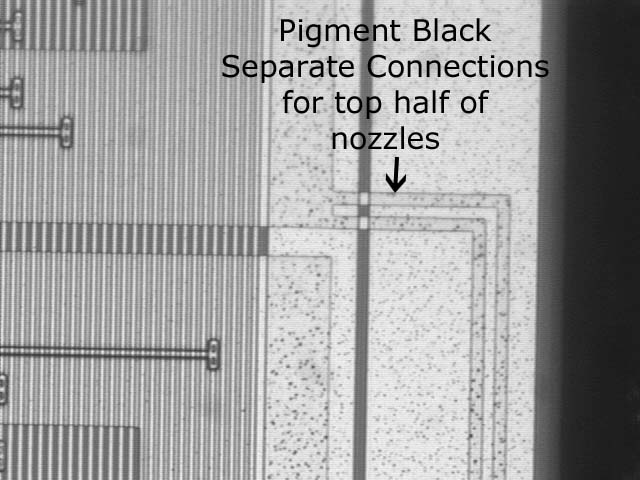

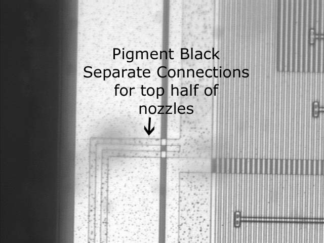

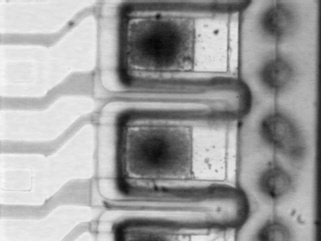

I decided to put Zack23's print head under the microscope again before proceeding with the destructive tests. This animation was generated from several shots where the only difference was that the microscope's stage was moved down (away the lens) between successive shots (there was no lateral or vertical movement of the print head between shots). At the start of the animation, the focal plane was low enough that nothing was in focus. As it progresses, the bottom of the nozzle comes into focus, as well as the circuit layers. Further along, the exit of the nozzle comes into and then out of focus. I wish that I could say how much the stage moved for this sequence, but I have no idea. Finally, on the last shot, two circles were added showing the size of perfectly round 1 and 5 pl ink drops (these are 5 pl nozzles). The ratio of the drop diameters is about the same as the ratio of the nozzle diameters (shown in a previous post).

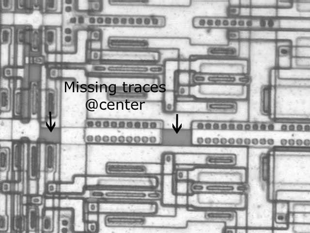

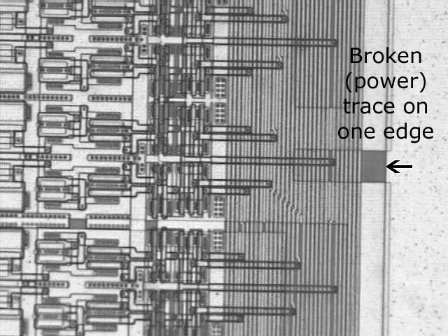

There have been a number of instances reported where one or both sides of a set of nozzles fails for exactly 1/2 of the nozzle. It has been theorized that this might be caused by an electrical failure. This opportunity was taken to look at the circuitry at the midpoint of the nozzles for anything that might explain this failure mode. The following 2 thumbs (click on them for a larger image) show the right and left edges of the pigment black nozzle set (160x2 nozzles) at the midpoint. Both sides show a break in one of the main traces at the midpoint, and a connection with two external traces from that point on.
The following 3 thumbs were taken from the dye ink nozzles. This image shows a break in some of the traces at the midpoint (this is the only place where this happens on the color nozzles).
This image shows another difference in the design that happens only at the midpoint. There is a discontinuity in the design at this point, with a slight extra space being added.
This image shows a discontinuity in the traces on one edge at the midpoint, similar to what was seen on the pigment black nozzles. There was no similar break seen on the other edge.
ghwellsjr
Jun 16, 2006
3,645
85
La Verne, California
Epson WP-4530
Grandad35, again, awesome work.
I don't see any evidence of angling of the nozzles, is that what you concluded?

ghwellsjr said:
I don't see any evidence of angling in the nozzles, is that what you concluded?
Yes - neither the 1 nor the 5 nor the 30 (pigment black) picoliter nozzles showed any indication of being angled.
In the last post I forgot to mention that the 1&5 pl nozzles ARE located symmetrically about the center of the print head, with the 1 pl nozzles always being inside of the 5 pl nozzles.
I should have also drawn the conclusion that there is something happening at the center of each column of nozzles indicating that (probably) the power supply to the nozzles is split at this point. This could explain the loss of exactly 1/2 of a column of nozzles as being an electrical problem in the print head. Unfortunately, such a failure in a power trace also has the potential to damage the mother board, so a new print head is not a guaranteed fix for this problem.
While looking at the animation again, I noticed something that I hadn't noticed before - that active etch extends around the nozzle, but at a deeper level than the other etch. Being deeper, it is out of focus on the other shots, so it wasn't obvious.
It is possible that this is the actual heater, and that the device previously described as the heater could be a power transistor. Perhaps someone who knows what these devices look like could chime in on this.
