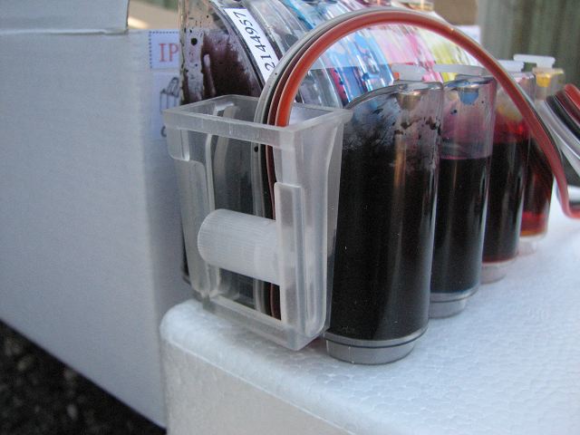

Here's some pictures of a CISS for the Canon IP3000 that I have just purchased from www.selectiveimage.com.au
The unit comes well boxed. The manual is made by a non native english speaker.
The tanks are see thru and have a main plug for refilling and a smaller hole for air filter ( not fitted in the photo)
At one end is a handy pinch roller to clamp of the tubes.
The cartridges are similar to OEM in design with the tube connected over the non sponged compartment with a push fit elbow. There is a neat modular bar to hold the tubes in place. Also the exit port clips twist off, but can be put back on the exit port and twisted so they lock in place - resealing the exit port - I haven't seen this feature before.

I have been pleased with this system. It has been well thought out. I even let the black run out inadvertently and as the exit port clip could be easily attached and the tube easily removed from the ink cartridge it was easy to reprime without getting ink everywhere.
To answer your question, the negative pressure created in the ink cartridge as ink is used draws ink in via the long tube from the reservoir. In a non CISS when the negative pressure is created by using the ink air is drawn into the cartridge and eventually it runs dry.

Very observant.
The uninstalled system is not the same CISS set as the installed system. I have 5 of these and when they arrive after shipping there is often air in the line. If it is greater than a few inches then it pays to reprime these lines. I took the photo of a CISS just removed from its packaging and then one I had already installed in a IP3000. Priming can be done by having the cartridges exit ports sealed and the ink reservoirs at the same height, pinch roller not engaged and remove the elbow from the top of the cartridge and elevate the reservoir slightly until the ink runs along the line and drips out the end into a dish. When all the air is bled then replace the elbow into the top of the cartridge. (They are a push fit). Then do the same for each line that needs bleeding. Have used the selective image CISS in MP730 and IP3000, and it works well as long as you are meticulous with setup and then the beauty of CISS is that you don't have to keep fiddling, just keep the reservoir topped up.
With the pinch roller engaged - photo 3 - you can them move the reservoirs relative to the printer unit. A few inches of air will often make its way into the lines above the cartridges but this doesn't seem to matter. After periods of inactivity (days) often a few inches of air is observed. One thing I have done with regards the IP3000 and this CISS unit is to elevate the CISS reservoir about 40mm above the desktop. The reason for this is to minimise the pressure needed to draw ink into the cartridges from the reservoirs. Thus the seal between the cartridge exit ports and printhead is minimally stressed. This is an area that is problematic with the canon cartridge/printhead design. care must be taken not to over elevate or ink may well siphon continuously out of the reservoirs into the cartridges! I have the feeling that elevation of the reservoir is tolerated by the sponge cartridges but the spongeless CISS maybe less tolerant of this. I have a MP730 with the same CISS and only elevate the reservoir 20mm. The CISS suppliers advise putting the reservoirs in a universal position - ie. the desktop, but the distance from the desktop to top of cartridge is not the same distance in different printers even though the CISS units are the same, ie MP730 and IP3000. I try to estimate the top of the ink in the cartridge and the top of the ink when the reservoir is full and keep the reservoir level a little below.
I wish I could understand the apparent double ink tanks, with the shorter ones in front of the taller ones. Can you tell me exactly what air vents are at the tanks, and are the two tanks for a color directly connected or do they have some special connection system?
The physics of these cartridges are simple. They are modified from the same type of cartridges as the Canon OEM. There is a big sponge compartment and a smaller adjacent compartment these are connected via a hole in the bottom of the separating partition. Normally there is an air hole above the sponge compartment in the OEM non CISS cartridge to allow air into the cartridges as ink leaves. The sponge acts as resistance to the outflow of ink. In the CISS setup this air hole is closed and the ink line from the CISS is connected to the top of one of the compartments. ( In this setup it is over the smaller non sponge compartment , but can be over the sponged compartment. ) When negative pressure is created in the cartridge then ink is drawn in from the external reservoir via the connecting tube. The height of the ink in the smaller non sponged compartment should remain constant. You can vary this height when you prime the initial setup. My judgement is that filling this compartment about 2/3 full but not greater is best. There is no doubt that having the cartridge near full allows it to last much longer than the refillable cartridge setup.
