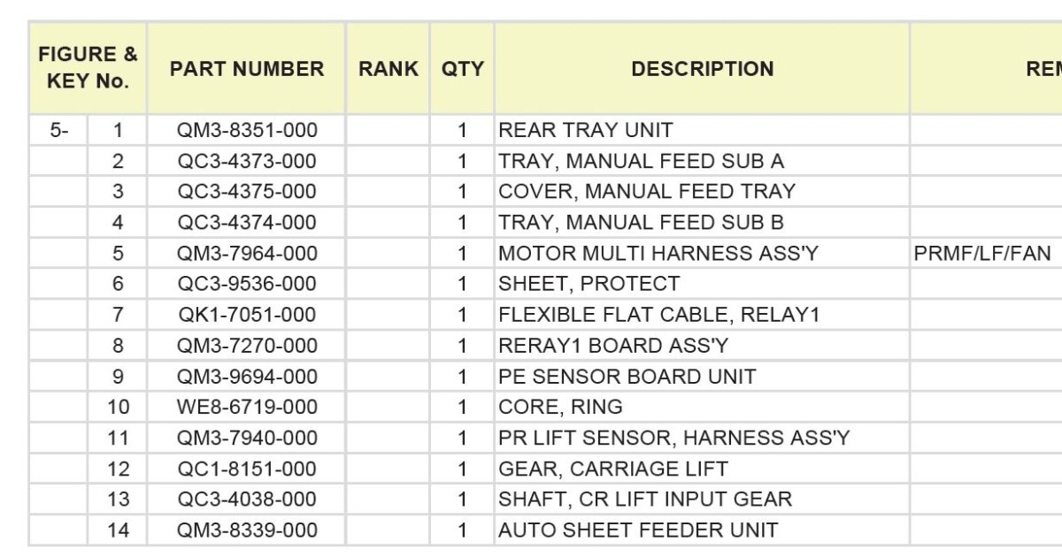

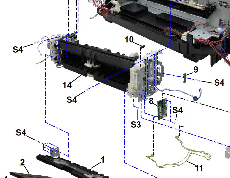

Sir: I just dropped $300 US on a Pro-1 that I saw working. I took it home and hooked it up only to be presented with the Error 1851 that the CD tray is open. I've got the printer 'stripped' of its panels but I cannot find where the possible sensor the CD tray is located. I'm not sure this USA Model even came with the CD printing tray. I have read that some have shorted out the two wires that lead from the sensor ... I have no idea where these wires might be.
Can you suggest a solution? or direct me to some info that may help me, like a wiring diagram for this printer?
Daniel
16,169
9,121
As this is a Pro 1 printer, you may be getting an erroneous error, so it may not be the actual problem at all.
To fix:- Close the front paper tray and press the resume button, then start a new print job again, this time it should tell you to open the front paper tray to proceed....
Mostly I would tell you to return this beast and get your money back and put it towards a second hand Pro 10 or a new Pro 300, at least that way you have a chance at care free printing..
The Pro 1 is not a printer that will allow you to tinker with and should be avoided at all times, this thing is a living hell when it comes to diagnosing any issues that may arise, it either prints or it doesn’t and no amount of fiddling with ever change her mind..
P.S. the Pro 1 comes with a CD tray on all models ever built regardless of region..
