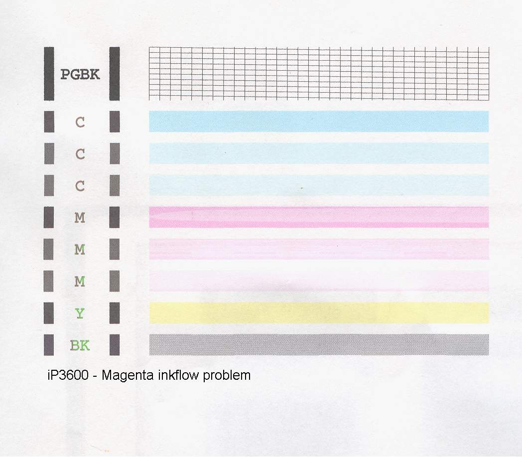

To me there still looks to be a problem with magenta. Regular magenta seems OK in strength but with some clogged nozzles. The medium strength magenta seems too weak and the light magenta is almost missing. I know that different scanners see colours differently and some adjustment of settings is often needed to get a good scan of a nozzle check. But note the green tint of the "CCCMMMYBK" lettering that ought to be various shades of neutral grey.
Here is a nozzle check showing a magenta ink flow problem and green discolouration of the lettering. It was made when troubleshooting this problem: http://www.printerknowledge.com/threads/canon-mp540-strange-magenta-inkflow-problem.6904/ , click to enlarge:
Both a cartridge problem and a print head problem could cause the intermittent error. To rule out a cartridge error I, like The Hat and stratman, strongly suggest trying a new OEM magenta cartridge, to reduce number of variables. Compatible cartridges may or may not work perfectly, so they are not ideal for troubleshooting.
I think a clog in the fine channels in the upper part of the print head, from the ink inlet to the nozzles, could also cause the error. I also think that worn rubber gaskets at the ink inlets could cause such an error, so you could try interchanging the rubber gaskets from magenta and for instance photo black or yellow to see if the error now affects black or yellow. Do the cartridges click firmly in place or are they a loose wobbly fit?

See what you mean PeterBj but the original has not transmitted very well. I have the original in my hand and all 3 cyan/magenta stripes are well defined and the text is the grey. I tuned it up a bit in Navigator but it certainly looks a lot weaker in my post. Will try another enhancement program and try and post a better picture. Also note your comments about the gaskets and the cart fit. I have always thought the canons lock was a lot lighter than HP and you can easily dislodge a cart when removing/inserting another.

I had a good look at the nozzle check again and the magenta does have a number of dead spots
in it and this is also reflected in the “CCCMMMYBK” lettering which are green..
7,171
The image from barfl2 does appear to have defects. Are these scanning and JPG resolution errors? Actual defects? OP seems to say the nozzle check is good. Does he know what good means? I would hope so.
Looking at OP's last nozzle check, and without any enhancement other, it appears there are evenly spaced horizontal lines in topmost and most dark Magenta. If this is true then the logic board is most likely kaput. A somewhat similar effect can be seen at the bottom of the BK horizontal bar. I have seen this before on other people's nozzle checks and they have claimed their print outs are perfect and that it is related to scanning and/or conversion to JPG.
The light color intensity of the Cyan and Magenta second and third horizontal bars may or may not represent an issue if OP's statement on things looking good is accurate and the issue we note is due to scanning and/or JPG conversion.
There also appear to be small horizontal linear deficits near the bottom of the solid vertical black bars of BK, M, and C. There are also some shading differences in these bars for C and M.
Concerning PBBK - There are two missing nozzles top center and one potential partial nozzle issue 4th row, 3rd column. This is a cursory exam and more issues may be present. Continued printing and/or soaking may cure this.
Other than the PBBK deficits, the others issues remarked on may be scanning/JPG issues and OP's nozzle check may be good as he claims.
