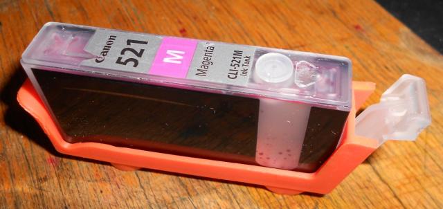

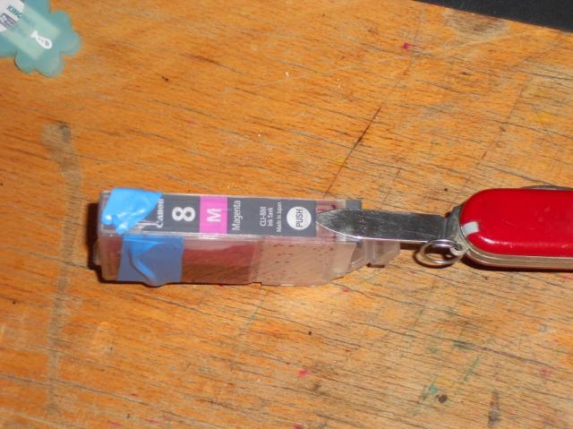

This is a picture of a cli8, but it works the same on cli521:
<-- click to enlarge
First I cut the label just below "Ink Tank", then I raise it a bit just like in the picture. There is a small indentation at the end of the label so you can grab it with a knife. It peels off, but you need to do it slowly so it will not tear. All that is left is some glue, but that will not interfere with the plug.
cli-521 with label and ball removed (plug and clip from octoink):

But I am still stuck with removing the label on the cartridge top I have tried Tudor advice but I am still unable to get even the smallest but of label to lift up. Is there anything I can use to help lift the label a little so I can peal it off please?
I would think to get a air tight seal with a plug i will have to remove all traces of the lable.
One other question are the cartridge chips specific for the colour or will any CLI521/520 chip work with different colours.
Regards to you all
7,179
It's a bear to get off. Patience is a virtue. Maybe someone has a super secret method, but I've not heard or discovered an "easy" way to remove the label as completely as is seen in some people's photos.
If you are going to Top Fill using the ball extraction method, you can just remove the portion of the label above the dimple where the plastic ball is sequestered and use a low-profile silicone plug from Octoink.
Maybe you are beginning to understand why the Durchstich method is simpler, from set up to every refill thereafter? :frow
YES. You cannot mix and match. The Cyan chip must be mated with the cartridge you use for Cyan ink. Same with every other ink color. FYI - no one has figured out a system based on configuration or markings to allow for identification of the chips when separated from their cartridges. The only way then is to insert the cartridge with the chip in the print head until you find the correct slot.
