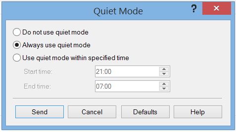

Sometimes it helps to use quite more, this slows down the speed at which the printer works, and can prolong the life of the print heat.. And no it's not a design flaw, because OEM inks doesn’t have the same issue.
