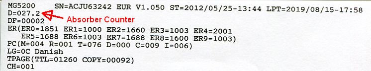

Yes the service tool V3400 is compatible with the MG5250 as seen in this crop from the EEPROM print of my MG5250 that was created using the v3400 service tool. D=xxx.x is the absorber counter value. 0 means the absorber is empty and 100 means the absorber is totally full:

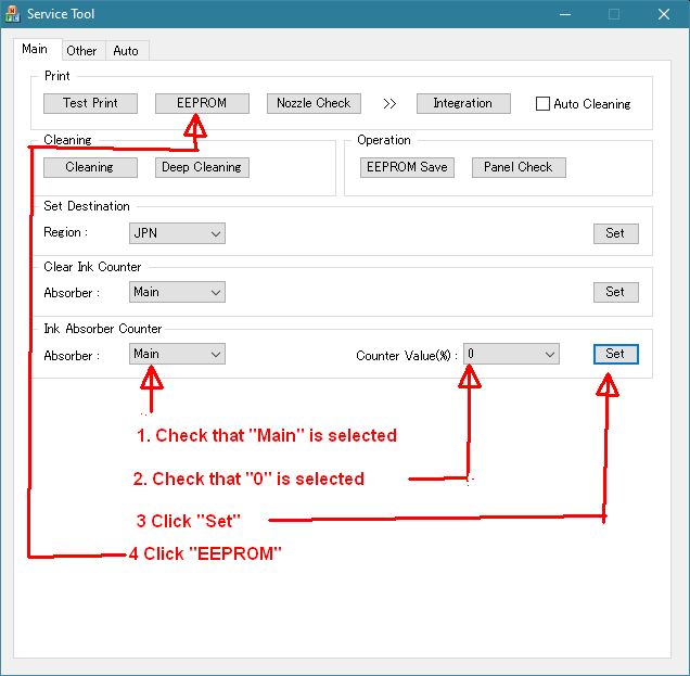

The service tool can only be used with a Windows computer, you cannot use Mac and Linux computers. The service tool only works with a USB connection, Wireless cannot be used even if the printer has this capability. It is also important that only the printer you want to perform service mode operations on is connected to the computer. No other printers must be connected to the computer.
Here is the procedure to enter service mode from the service manual, slightly edited to make it more clear:
When the printer has entered service mode Windows will probably install a new printer or a "device". just allow this.
Make sure there is paper in both the cassette and the rear paper feed as you cannot predict which paper source the printer will use.
Now open the service tool. Check that "Main" is selected in the ink absorber counter, and "0" is selected in the "Counter value%" setting and then click "Set".
A small window "A function was finished" opens. Close this window by clicking OK. Now click the EEPROM button to get a print that verifies that the absorber counter has been resat. D should now be 000.0 or very close to 0.
Here is a screen shot with explanations:
I hope this helps.
