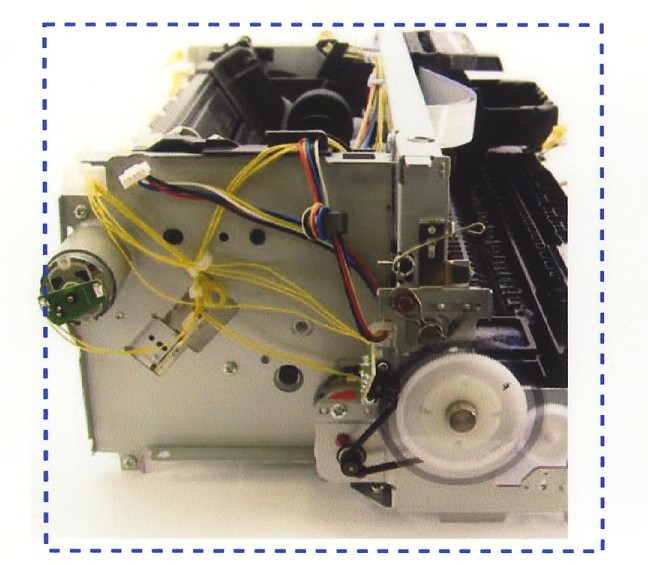

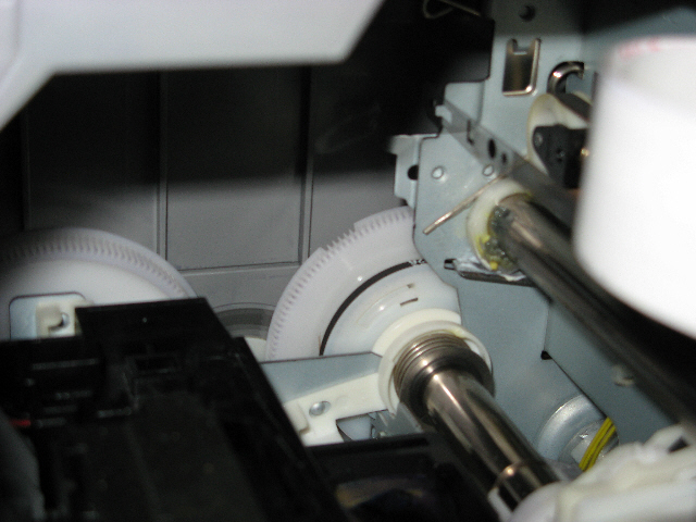

I tried to look at the timing wheel as best I could when the unit is powered on. One time it came to rest at a point where, this is a little hard to describe, although the outer (leftmost) side of the timing wheel for most of the 360 degrees is slightly higher than the further left of the two rows of teeth, there is a spot where 5 teeth (consecutively) do not have that higher part behind (to the left of) them. Here's a picture.
Is that the normal appearance of the timing wheel ? It looks so cleanly cut, I suspect that it's as it should be, but I am not certain.
Also, if the problem was due to a malfunction of the timing wheel, why do I consistently get one further inch of good printing when I use the "Plain Paper" setting?

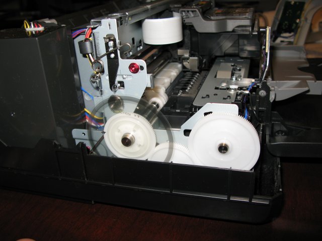

yuyakay,... Unfortunately I do not have close up pictures of the iP3000, but I do have pictures of the timimg wheel for the iP4200 and it does not look like your picture. Here it is below;
You can enlarge this image and see there are no teeth missing. Also, the gears attached to the main shaft also contain the large Timing Disk. The image you show has a much smaller timing wheel inbetween the two gears. This I don't understand at all since I have a detailed iP3000 Service Manual with rather good digital pictures and the manual is in PDF format which allows me to enlarge it up to 500%. It show clearly that the timimg disk is attached to the main gear and the main shaft. I'm beginning to think you don't have a iP3000 printer. I don't understand why your internal picture does not look like the Service Manual.

Yuyakay that picture looks exactly like my iP3000 with the small clear timing wheel in the center.
The gear is the same on my iP3000.

Ron350, Thanks very much for comfirming that it matches your ip3000. I don't know what the problem is with these pictures and the Service Manual I have. It turns out I do have a very good picture of the iP3000 from the newer Simplified Canon iP3000 Service Manual. The only thing I can think of is that somewhere along the line Canon changed the inside guts but that does not make sense either. They would have come out with a new model number.
Just to help muddy up the water I will print out the image from the iP3000 Service Manual, Scan it and upload to this thread. I'm very sure if we tried to ask Canon Support about this, we would not get any answer except, take it to a Authroized Canon Repair location. Here is the picture of the chassis;
And here is a picture of the end view of the chassis.
These pictures clearly show the timing disk connected to the main shaft and in Yuyakay's picture there is no timing wheel on the large main shaft. At least it is not visible. Where did it go. Also, you will notice there are no missing teeth on any of these wheels. Is this possible a iP3000 printer shipped to a different country???? Is it a US model or is it Far East, Europe, Asia, Japan, etc.

Trigger37 the timing wheel is in Yuyakays picture its just hard to see.
The timing wheel is small and mounted on the idler gear between the two large gears.
