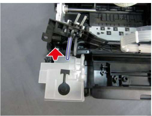

I haven't fully disassembled one of these machines yet but I would assume there is something to force ink down the line while printing?
at a glance(from pictures/poking around with a flashlight) it seems like it uses the mariotte principle as most third party CISS tanks do albeit with a weirder tank design where majority of the volume of the air balance chamber in a regular ciss tank is replaced by an air inlet tube running towards the top of the tank.
I wonder if the design changes makes the system less forgiving of the printer not being level. The top of the smaller chamber is at most level with the bottom of the printhead with the rest of the tank sitting about 1 cm below that level
Photo from the G4000 service manual
If it doesn't have any way to pressurize the lines even slightly, then it's no wonder it has air intake problems. I know it costs an extra buck-twenty a unit, but I'd have liked to see a pump on each tank, i.e. the purge pump, that would be firmware-controlled to automatically replenish the "dampers" (if you can call them that) every so often with a small kick of pressure. But then you'd also probably need actual dampers.
I don't know if it was because of me moving it, or the new angle of the printer, or just a bad day, but I just had all four of my lines take on air after moving my printer. Then I did some deep cleans as usual which took care of it until it didn't. Inadvertently starved the print heads for a chill 12 pages (but didn't cook them thankfully). I wound up doing the first part of an ink flush cycle to make sure the dampers got a good helping of ink and now it is working fine again. The printer used to be on a stand with a slight incline at the front, with it now being pretty much level.
