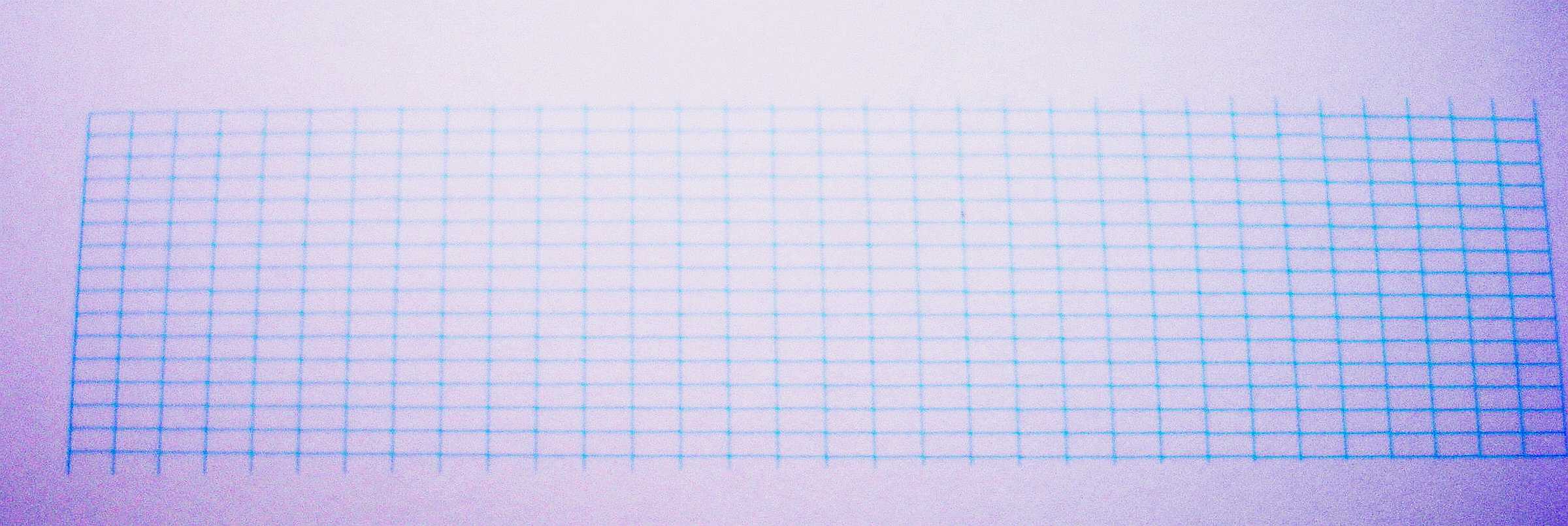

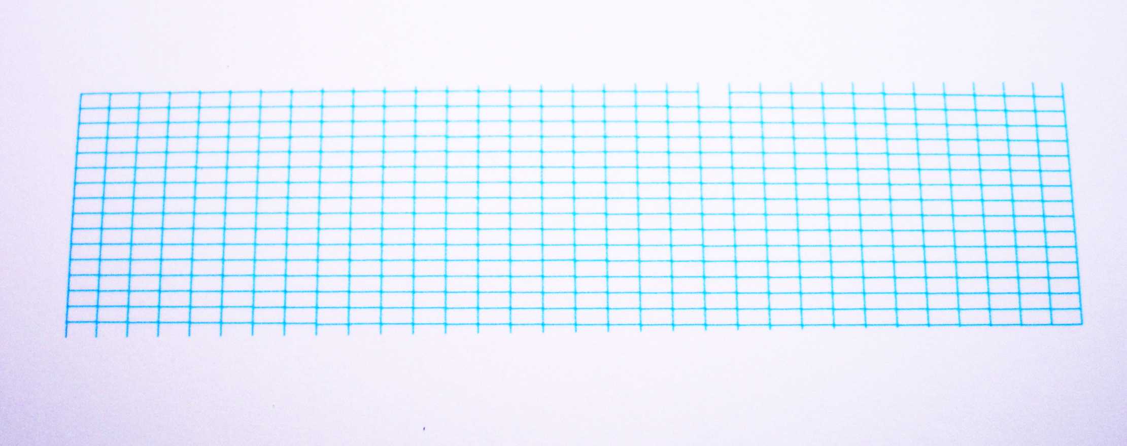

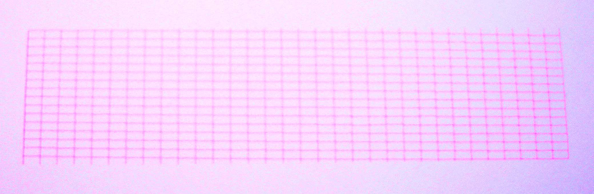

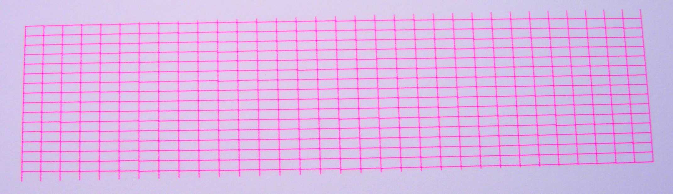

OK. here's the best I can do to shgow you the extended nozzle check patterns. You can see that one nozzle on the Magenta check appears missing. All else looks OK (excuse the enhancement artifacts).
PLEASE NOTE THE RED ANNOTATED AREAS OF THE BLACK NOZZLES. If I understand past posts correctly, succesive horizontal lines-nozzles should be incrementing DOWN after each vertical line. At the red circled areas, latter lines are distinctly printed ABOVE the prior line. If the printing nozzles increment downward during the extended check, how do later horizontal lines, at times, end up ABOVE the prior horizontal lines?? This happens in the color areas too, but it's hard to see in the photos...
Comments??
MAGENTA PATTERN
PHOTO MAGENTA
BLACK
PHOTO CYAN
CYAN

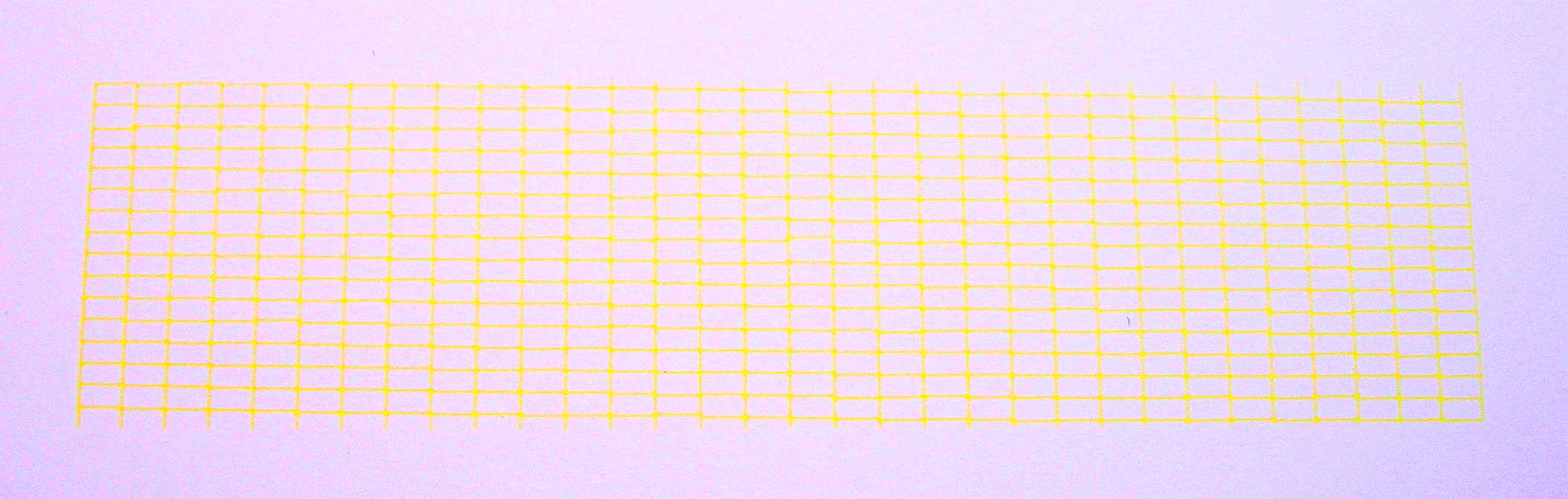

OOPS! Forgot the Yellow..
YELLOW
