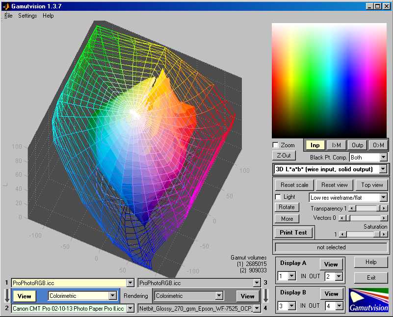

Jtoolman wrote:
However the Prints produced, using that profile produced the most beautiful, but PSYCHODELIC prints I've ever seen. Similar to if I had partially solarized the image and posterized it. Soft proofing confirm it as well. The ICC profile is very small, less than 500 kb
You may remember the profile. I had a look at the profile I produced with Canon CMT in Gamatvision and this is the result, its like the Rocky Mountains on one side. This is compared with ProPhotoRGB as the outer net.

I was in such shock when I saw my results after using the profile I made I deleted it and decided to not waste another three sheets of paper to try again.
I still have the print outs and should rescan them just for fun and them view the gamut map against my Regular ColorMunki produced one to see where the "Holes" are.
