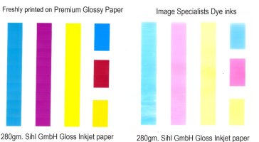

This next bit was not supposed to be in this test but I taught why not and added them in a week later, for this I used Image Specialists dye inks From OctoInkjet printed on my i9950 and the Canon 56 pigment inks on my Maxify.. Again printed on the Sihl Glossy Paper..
Now I reckon the dye inks stood up to the test extremely well, compared to the black dye ink, these inks are 12 years plus old and still going strong, but are mostly unavailable anymore..
Now the Canon bottled 56 pigment inks faired out lousy, in fact the colour vamoosed nearly as fast as the coloured dye inks did, at least the dye inks were still mostly present and held their colour and didn’t disappear.

That's a very interesting and comprehensive test, and I only can agree with your conclusions
- all inks fade - some slower and some faster -
- pigment inks don't fade necessarily slower than dye inks - just because they are pigment inks
- if fading performance is of concern for a user only evidence by a test can show the real performance - but data of fading performance is scarce so it's easy for vendors to promise 'UV resistance' without proof and consequences
- I'm not commenting again that Canon or Epson don't tell their customers about significant performance differences of their bottled Mega/Ecotank printer inks - for a pretty similar price
