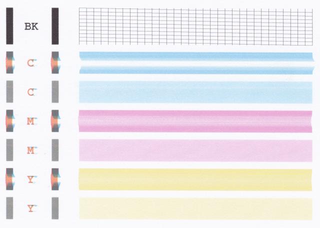

I have an mp250 and I refilled the cartridges:
- black - I still have the cartridge that came with the printer, refilled 5-7 times with no problems.
- colour - the cartridge that came with the printer was damaged after the second refill, so I bought a new CL-511XL cartridge and managed to refill it once before it was damaged. I refilled it before the ink ran out. It doesn't give an error, but it is unusable (exactly like the first one):
I don't know if the printer damages the cartridge or if I did something wrong. Because 2 new cartridges cost as much as the printer, the best solution to this problem was... a new printer(ip3600) which costs only 50% more than a new set of cartridges for the old one.. :)
Maybe you will have better luck with it.
