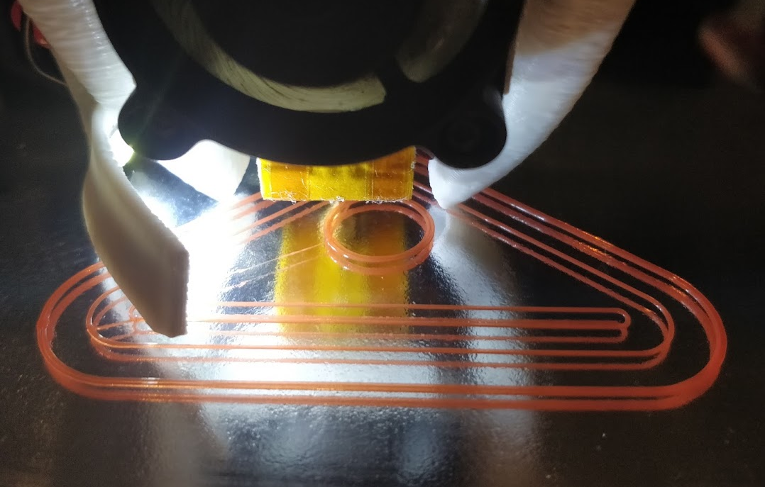

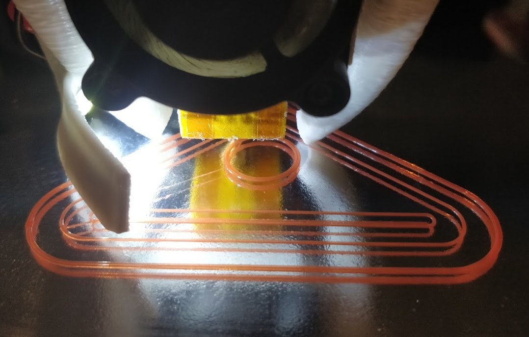

Over the past year, I've pretty much exclusively used blue tape on top of the glass bed that came with my CR-10. It pretty much works perfectly every time, and I don't ever have to heat my bed... which is nice because I'm super impatient.
A few months back I purchased mirrors from Home Depot and tried to print on them with glue, hair spray, etc. but it just never worked for me, so I gave up and went back to painters tape.
I stumbled on this video: https://www.youtube.com/watch?v=T5jFf6L5LYU
... and decided to give the mirror another try.
Printing right to the glass alone didn't work. I honestly think it's probably impossible to print to a cold glass bed without anything on it.
So, I next put on some purple elmer's glue in the method shown in the video... and then this happened:
I'm going to keep playing with this method and see how it compares (pros / cons) to the tried/true tape method!
