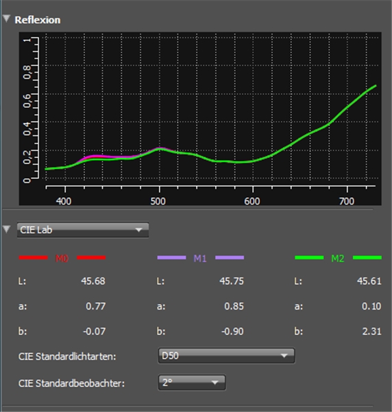

That's one of the problems, let me show you how bad this far-red region can be
what would you expect from a perfect neutral gray print - technically neutral, the visual impession can be different.
Analog film photographers in the past had a gray card for exposure adjustment and help with contrast control in the darkroom.
When you scan the spectral response of such a gray card you get this
That's pretty much a flat response for a medium gray at L= 47, and such a gray will look gray still at other ambient light conditions than D50.
I profiled an L1800 longer time ago , a printer w/o a light gray, and I get such a gray under these conditions for a L=46 gray
That's technically a neutral gray as well - at D50 - but this gray will look pretty much different under all other light conditions. The bulge at the far-red end of the spectrum is significant.
Nice illustration! Carbon black pigments have a much flatter reflectance spectrum. I suppose other grey inks are simply diluted black dyes with similar spectral issues? Have you ever checked your ET8550?
