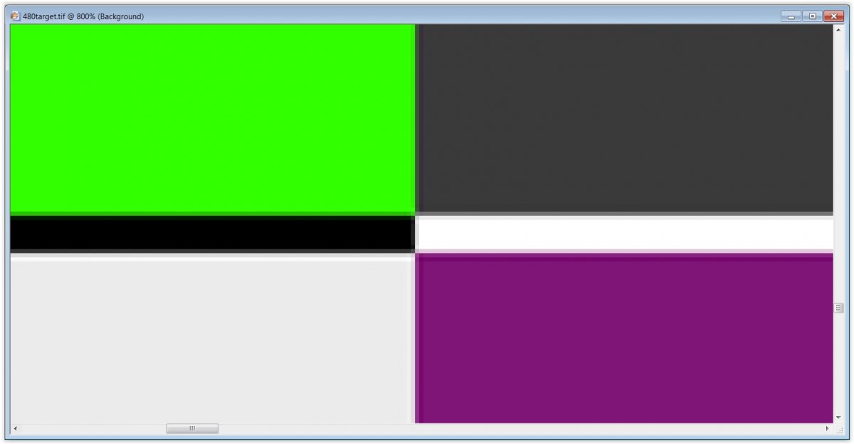

It's more a matter of interest - why do you use a 16 bit color depth for a file which should provide 480 colors ? Did you do any resizing of that file - the color count of unique colors gives me a number of 46 000, and even if Iwould reduce the color depth to 8/24 bit it still counts 16 000 of them . The edges between the color patches and separation lines appear to be resampled . Just magnify some area by 10x. These additional colors are along the edges and most likely not in the middle within the reading circle of the spectro and would not change the results, but I'm wondering about the patch file generation process.
Not sure why I did use 16 bit color depth, but I presume it would increase accuracy. I did resize the file using Photo Shop to elongate the patches so more samples are taken from each color patch when reading the rows with my Colormunki. Note: everything is done using tiff without data loss and compressing the final file is done with LZH compression (no data is lost). I think the elongating process seems to have introduced some artifacts near the color borders, but as you have mentioned: it doesn't change the results at all.
