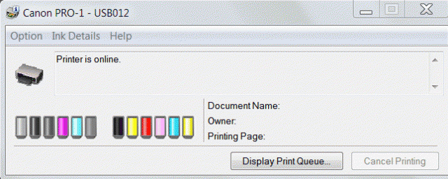

When you have run out of ink and your printer wont print anymore
then just follow the on screen messages you get from your printer as follows.
On the first message youll get low ink warning, refill that cartridge and continue to print.
Youll get another out of ink warning later for the same cartridges that you have just refilled,
at this point just press the resume button (Orange Flashing)
and hold it in for five seconds and the printer will continue to print.
Later youll get another one saying youre out of ink (Final) but do the same as you done before
and the printer will continue to print uninterrupted for then on, no more interruptions.
But a few words of caution here please check that cartridge at regular intervals
to make sure you don't run out of ink and if it looks low refill immediately, dont wait.
Later on when you get a new cartridge or chip, your ink monitoring will return as normal on that particular cartridge..
This is just an example of how your ink details may look
