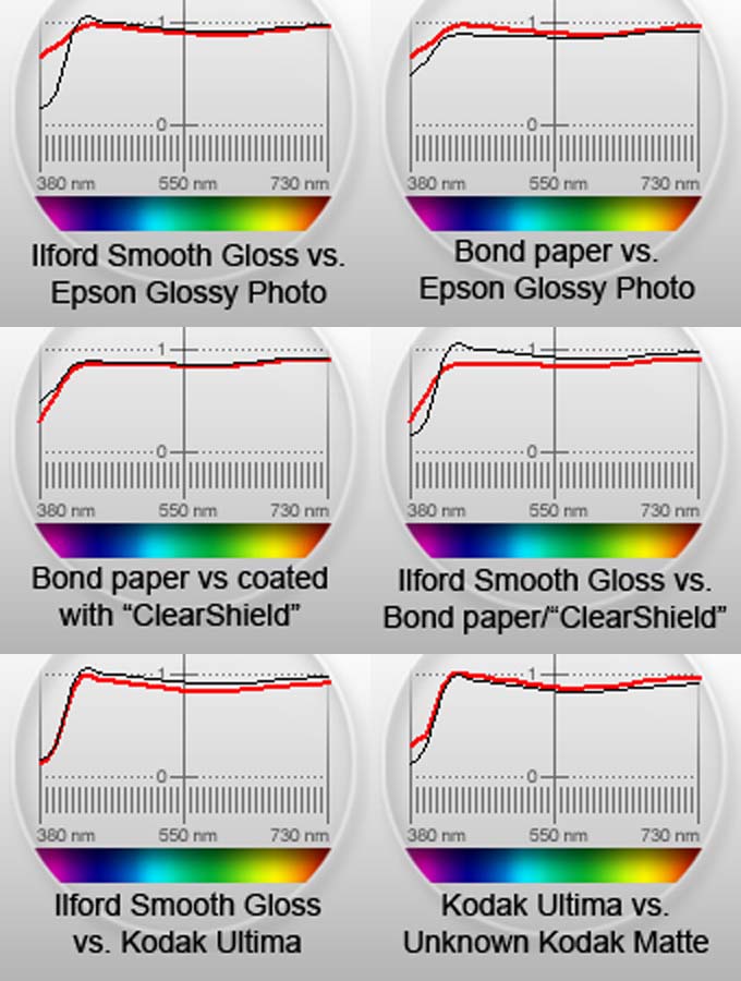

Another "post for nerds" on the effect of paper and coatings on UV damage.
I rounded up several samples of inkjet photo paper that I had in the house:
Kirkland Glossy Photo Paper
Ilford Smooth Gloss (ISG)
Ilford Smooth Pearl
Ilford Classic Pearl
Epson Glossy Photo Paper
Kodak Ultima (100 year) Photo Paper
Kodak matte photo paper (I couldn't find the box to identify it further)
Standard bond paper used in laser printers
A piece of the bond paper was coated with the "ClearShield" UV resistant water based acrylic coating recommended by Livick. A second piece of bond paper was sprayed with a generic acrylic clear coat that did not claim to be UV resistant. All of these samples were measured with the spectro set to measure how they reflect light, and several important comparisons are shown in the image below. See the previous post for a description of the charts shown on this image.
All 3 Ilford papers gave similar results, with the ISG being the "whitest" in the middle wavelengths and also having the best reduction in UV at the left of the chart (but only by a little - all three Ilford papers were very close). It has been claimed by many that the Kirkland paper is made by Ilford. Since its chart was very close to the Ilford papers, this statement could be true.
The first chart shows a comparison of the ISG with an Epson Glossy photo paper. Note that the ISG is whiter in the middle wavelengths and also does a much better job at absorbing UV. Chart 2 shows that the Epson paper has almost the same (low) UV absorption characteristics as regular bond paper. If the coating on an inkjet paper absorbs UV, there will be less harmful light reaching the dye buried in the coating, and the print life should be improved. Perhaps the Epson paper is designed for pigmented ink, where the pigment particles would close to the surface, and where any UV absorption in the paper's coating won't be of much benefit.
The 3rd chart explains why Livick saw an improvement by coating their prints with "ClearShield" - it absorbs UV before it gets to either dye or pigment based colors (since it is also on top of any pigment). BTW, I did coat some Ilford paper, but the Ilford papers already absorbed more UV than the coating (see the 4th chart), so no effect could be seen - this is why bond paper was used for this test. The spray-on acrylic coating gave no measurable difference in UV absorption, so these coatings should not be relied on for UV protection unless the container specifically states that it protects from UV. I should also mention that the left of these charts is only the beginning of the UV spectrum, and that I have no idea what happens further to the left. It is very possible that the ClearShield becomes more effective than the Ilford further to the left (deeper into the UV spectrum). This link (http://www.norquaytech.com/productoverview.htm) shows the effect of several commercial UV stabilizers in the UV spectrum.
The 5th chart compares Kodak's top of the line "Ultima" paper (in Red - rated for 100 years) with ISG (black). The ISG is slightly whiter (obvious in a side-by-side comparison), but the Ultima absorbs more UV. The 6th chart compares the same Ultima (black in this chart) with a Kodak matte paper (red) - the matte paper is whiter, but it isn't as good as absorbing UV as the Ultima or Ilford papers.
Here are a few more links on the subject for those who are interested.
http://www.cibasc.com/index/ind-ind...ility/ind-pla-eff-dur-lig-lightstabilizer.htm
http://www.pegasusassociates.com/products/UVFilters/UVfilter.html
http://cehs07.unl.edu/cehsabstracts/docs/Vamshi Naarani Abstract.pdf
http://www.signindustry.com/finishing/articles/2003-09-11-WhatDoesUV.php3
http://www.cibasc.com/index/ind-ind...effects/ind-img-pdi-dig-eff_lightfastness.htm
In summary, it appears that Kirkland and Ilford papers offer some UV protection. As Livick has shown, coating your prints with ClearShield will offer further protection because it reduces the UV that gets to the substances that have been dyed and also because it will help to seal the surface of any nanoporous papers in a similar fashion to swellable polymers. Kodak's "100 year" paper has excellent UV absorption characteristics, and this may contribute to its extended life, in addition to its use of a swellable coating. The Ilford Calssic Pearl also uses a swellable coating and it has nearly the same UV absorption characteristics (at least as far down as this spectro would measure).
