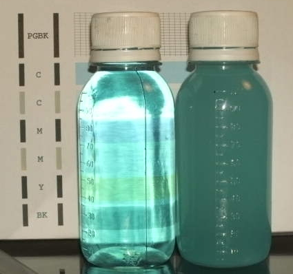

turbguy wrote:
Try filling the sponge/cart with Windex, then remove it (draw it out) with a paper towel in contact/rubber-banded to the outlet. You might be VERY surprised!
Wayne
To flush the Windex out of the cartridge I think only distilled/demineralized water should be used. Hydroxide ions formed by dissolving ammonia in water in the Windex reacts with Calcium ions in hard water and forms Calcium Hydroxide, which is not very soluble in water and precipitates. Ca2+ + 2OH- -> Ca(OH)2 The two bottles both contain a 1:1 mixture of a window cleaner with ammonia and water. The window cleaner in the left bottle is diluted with demineralized water, the window cleaner in the right right bottle is diluted with hard tap water. The Calcium hydroxide might clog the printhead, so if you prepare pharmacist's cleaning solution, only distilled/demineralized water should be used.
Click to enlarge:
