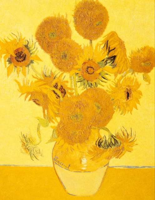

There are some cheap photo papers that work very well with 3rd party inks but in the end when your photos fade, the cheaper option is to just print them again.
OEM paper and inks are very expensive, but they fade too, so it’s not just limited to 3rd party stuff, when it really matters with you’re cherished photos a pigment printer would be the only option...
I had a glass framed Litho print of “Van Gogh's Sunflowers” on my kitchen wall and it faded severely, so UV rays tend to bounce all over the place in any brightly light room.
Sunflowers.PNG click to enlarge..

that's fading ? no - that's an artistic improvement to the original.....now all the yellows are even more present
View attachment 4404 click to enlarge..
I also observed that some cheapo papers with a not so good gamut resist fading rather well, while better quoted papers turn brown within a few weeks.
