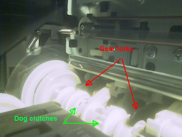

I have an ip3600 printer and the orange light flashes 21 times (alternates with green), any help would be most grateful or service manual link.
bit of history, I have done the waste tank reset and wanted to clean the waste pads so I cut a hole int the bottom of the printer (with a soldering iron :D)
I have removed the felt pads and I was going to fit a little waste tank but after reassembly I have this pesky 21 flashes.

near the print head drive motor on top right has a white cog on a arm that can go in 1 off 3 positions, which one do i put it in???,
I must have dislodged it when I had it upside down

ok there is 4 positions the cog on the arm can go,,,,crazy???

I read all the links, but i cannot find the drive switch, where might this be located on the printer there is several drive motors (I have all covers off)
21 times Drive switch
error
[C000] Drive was not switched
properly.
1) Foreign material or paper debris in the
drive switch area;
remove foreign material,
confirm the ink tank conditions, or
re-set the ink tanks properly.
2) Part replacement:
- Purge drive system unit
- ASF unit
- Carriage unit

I think that the "Drive switch" is not an electric switch but a mechanical switch like a clutch/gearbox mechanism. There are many motors ( 4 ? ) in an iP3600 and at least one does double duty both in paper transport and driving the purge unit. I think the drive switch area is located at the left hand side of the printer, opposite to the purge unit.
Here is a picture shot using a webcam inside a MP540, which uses the iP3600 as print engine. This is what I think is the drive switch. Note similarity with an oldfashioned unsynchronized gearbox. Click to enlarge:
The purge unit does more than suck ink through the nozzles to clear them, is also caps/uncaps the nozzles and locks/unlocks the printhead.
The list of suggested parts replacements indicates to me that error C000 is a mechanical error.
As some causes of this error message are foreign material in the drive switch area or ink cartridges not seated properly and thus blocking printhead movement, I think a probable cause of this error is that "the white cog on an arm near the printhead motor" is not positioned right. If repositioning this cog, trying out all 4 possible ways does not help, then try to check for other causes of printhead movement blocking.
If this doesn't help, sadly I'm out of ideas.
