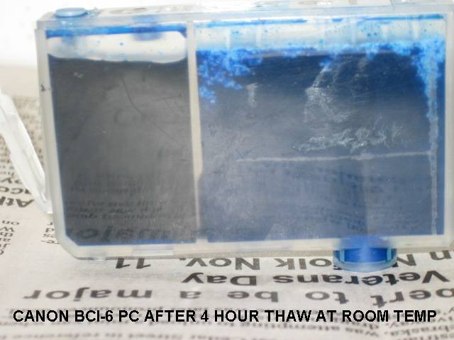

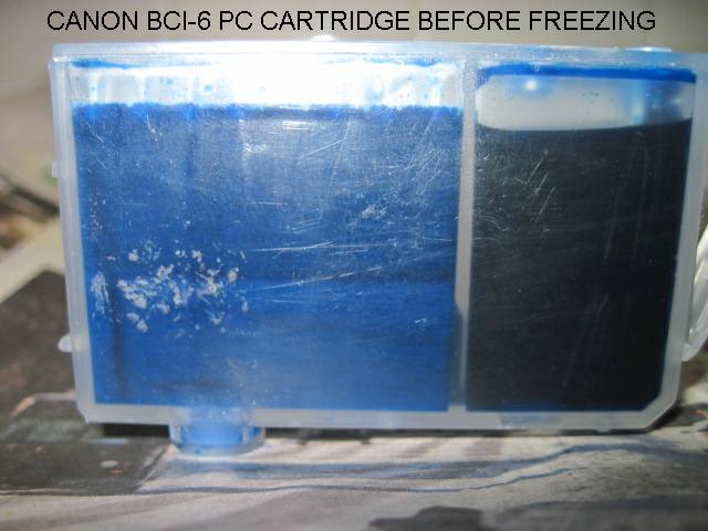

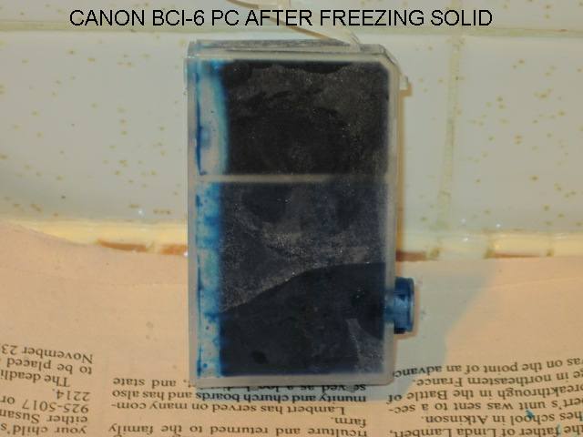

This now five days later (Christmas eve day) and I'm reporting back as promised. However, I didn't put a print head or a Canon cartridge with OEM ink in the deep freeze.

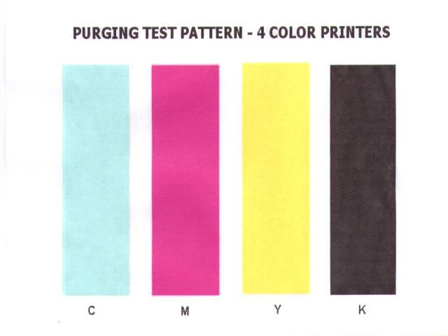

I filled a Canon OEM BCI-6 PC cartridge (flushed and dried sponge) with Hobbicolor PC ink. I put it into my chest type deep freeze for 2 days. I left it thaw out at room temperature for 4 hours and put it in a Canon i560 printer. I did two normal cleanings and printed out a 4 color bar chart. It seemed to suffer no ill affects.
The ink was frozen solid. A few drops of ink had escaped from the outlet onto a wax paper. There were no breaks or splits in the plastic cartridge. Check out the pictures.
