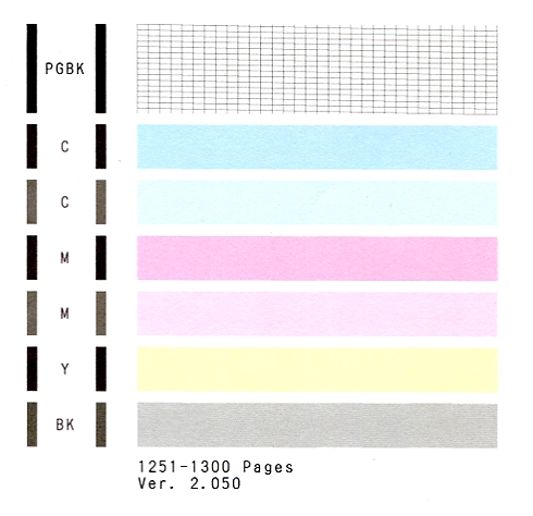

5,111
4,974
Newer Canon printers print the number of printed pages under the nozzle check. They also print the version of the firmware. I guess the Pro 100 will also print this info. Here is an example from the smaller Canon MG5550 nozzle check:
The Pro 100 has been sold for as little as 50$ or 100$ on special occasions, so that might be a reasonable bid for a used but OK one.

I ran a nozzle check on my Pro-100 and the page looks similar. This will get me going... I'll just take my laptop with me just in case they don't have the printer hooked up to a computer when I get there.

Holy crap, I never noticed the page count before....:ya
