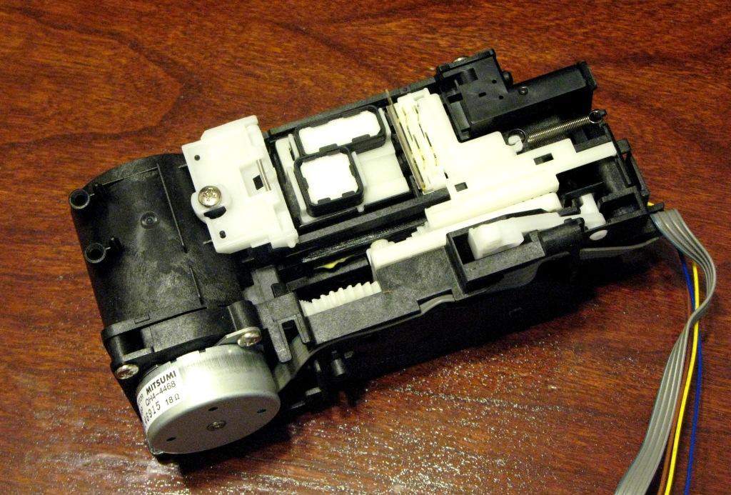

The 3 orange/green lights is a error signal which is basically a paper jam, or that the paper feed unit is not feeding paper, or that the purge station cycle is not working correctly. The actual error code is "Abnormal Line feed encoder signal". The Service manual also "Implies" that this could be a logic board problem, or anything in that path. Since the original symptom you mentioned was the loud grinding nose and the head will not move from the park position, it is probably the purge unit. This is the unit that "Lockes the printhead" in the home position. If this unit has a broken or dis-engaged gear, the head will remain locked in position. The purge unit must cycle one revolution to lower the locking tab. If a gear is back, it can't cycle. The is a photocell in the back of the purge unit which monitors the position of the purge unit and signals this to the logic board. This way the logic knows what is working and what is not.
Unplug the power cord. To get the top cover off, there are two tabs that lock the top cover in place. These are located on each end near the back. Typically you can use a flat blade screw driver to release the catch that holds the top locked in place. One released on one side, the top should pop up about 1/4". When the other side is released, the cover should come off. Once the cover is off, you can see the purge unit. The picture below is a "Clean Purge Unit".
On the right front you can see the small DC motor that drives the purge unit. Directly behind it is a large while nylon gear that drives the rest of the unit. Use a small flat blade screw driver to rotate the gear towards the front or motor. This will turn the gear in a counter-clockwise rotation. You can only turn this gear by turning one or two teeth at a time so do it slowly. At it turns the locking level, which is directly back from the large tooth gear will begin to lower. Once it is lowered you can move the carriage asm. Rotate the wheel until you see the purge unit cycle all the way through one revolution. Since the Carriage should be out of your way now, you should be able to see some part of the problem, i.e., some gear is not engaged or something is broken.

First I'd like to thank you for such precise instuctions, for when someone as inept as I can follow them successfully, they are good! I did exactly as you suggested, plugged the unit back in, and the first time it ran through the cycle, it did make a strange noise, but I was able to get it to print several pages, and I have not heard any strange noises since the first sheet. And it may be my imagination, but it also seems to printing faster than it ever has (it had the habit of going through several "practice" warmups previously, which I no longer notice it doing - but then maybe it only did that when it was "cold" - we'll see.).

Well, I really didn't do much, since I have a healthy fear of making things worse - I inspected all the gears I could see, and nothing looked wrong. Then I simply worked the large white plastic gear to the left of the purge motor counter-clockwise until it had moved everything through a complete cycle - then I plugged it back in and turned it on - on it's initial warmup, it made some noise, but it didn't sound quite as loud as when it was truly stuck. But it did complete the warmup, so I shut it off and turned it back on again - and this time there was no strange noise. So I took it back into its normal home next to the computer, hooked it back up, and printed off sev pages - absolutely perfect! And as I mentioned in my last post, this printer has always taken at least 45-60 seconds to go through multiple cycles before it finally printed the first page - however now it is printing almost immediately. Strange.
