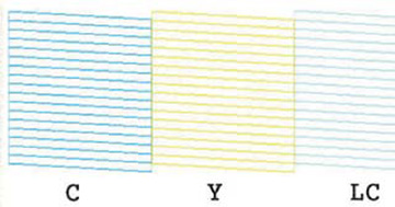

Are those actually ink stripes or scapes caused by rubbing up against the printer print head?
Here is an image of part of the nozzle check for your printer.
Each microstep down for each line needs to be straight and clean without significant feathering off that path for all 6 cartridges.
I also agree to try the alignment test as well.
If you need the manual for your printer and the details on maintenance, here is a link: https://www.manua.ls/epson/expression-photo-xp-8505/manual?p=1
If both come back clean and working and you still have lines, the print head may be striking the paper. Make sure you are using only the thickness of the photo paper that it supports. Too thick of photo paper will scrape up against the head.
If that is not the issue, the used printer may have had the head replaced improperly or something else out of alignment. I hope that one of the simple solutions above works for you

HI, here are the pics of nozzle check, for me looks totally fine, I did also both vertical and horizontal alignment, I use Epson 3 star 200g glossy paper for photos, so it should not be a thickness problem as well.
I have no knowledge about if this was ever serviced or fixed in any way.
I will try contacting local Epson support and see what they have to say, even though it is probably not worth it money wise.

Hi @kawliox
I think you should give the light magenta nozzle check another look and compare to the other colors
I stitched you two shots into one and you will notice that you should be getting a stairstep pattern with every nozzle and in the Light Magenta, you have straight to almost straight lines in all the areas I highlighted in green That means that those nozzles are probably printing off by ~1/2 to 1 nozzle width enough to cause the problem you have possibly. Thought is was worth mentioning.

Looking at that last image all your last picture, all your colours look bad, they all have lines in the printhead direction. To me it seems there is a paper feeding issue, and your printer might need PF adjustment or physical cleaning of the rollers.
If you want to go along with this printer, there are more things you can do yourself if you are up for it.
Although sometimes difficult to find, search for the adjustment program and service manual for your specific printer and print some test patterns there. In your case I would think the PF pattern would show some misalignment, but other parts might be misaligned too. In my last endeavour I had to adjust the angle of the printhead in order to get the PF adjusted properly.
