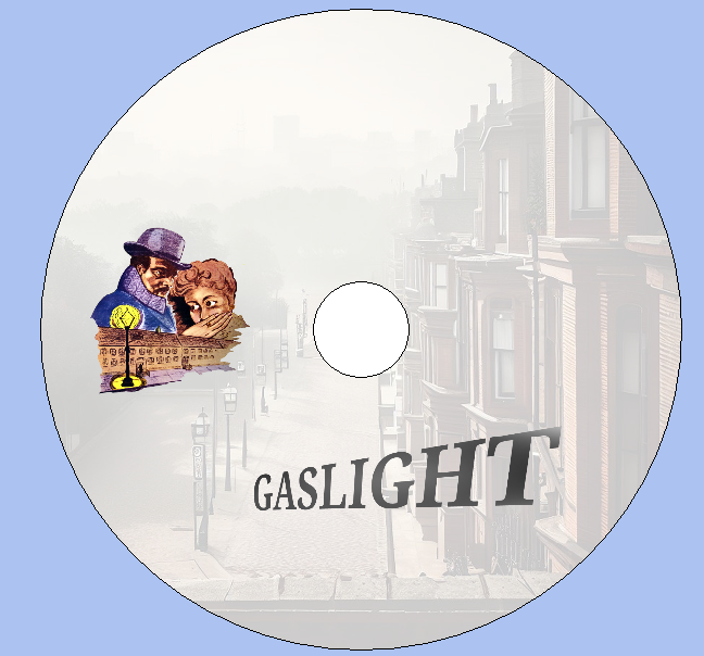

Here is the original image from Epson Print CD:

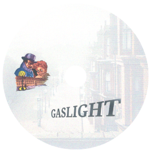

Here is a scan of the test print on plain paper:

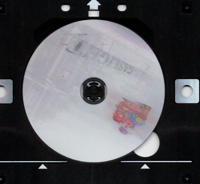

And finally, this is the best print I've been able to make, after trying several different brands and finishes of printable disc, and following Epson's advice to remove and re-install drivers and the print CD software:

Great pictures that show the problem
Are you using original Epson OEM INK cartridges? Not all inks work with printing CD / DVDs?

It does not appear to be one of the basic issues. Since I don't own such a printer, this advice comes from what I have read and heard.
It is important that you are using the Epson CD/DVD software and when starting it, that the CD/DVD option is selected. This step causes the correct printing profile to use for the CD/DVD which is different than normal paper.
The CD/DVD is further away from the the printer head so it will be more sensitive for things to be slighly off. Cleaning the print head is suggested when you get blurry images as slight misdirection of the ink will cause this problem.
Similarly, the CD holder and the CD itself needs to be rock soild in place. Any movement/vibration will also cause blurring. I understand that the carrier is supposed to lock into place solidly when inserted
Lastly, if you can turn off bidirectional printing on that printer that might help as well. Here is link to the PDF manual for your printer: https://files.support.epson.com/docid/cpd5/cpd56653.pdf
On page 290 and 291 it talks about speeding up printing by making sure Fast mode is on (bidirectional printing). You want to make sure that option it turned off for better print alignment.
Not sure this solves your problem yet those are the steps I would take if I had your printer

From what your describing it sounds like the print head is running far too high and the firing distance is causing the focus of the print to be blurry..
As to how you’d lower the height, I wouldn’t know because I don’t use Epson printers, so can’t help with that problem..
