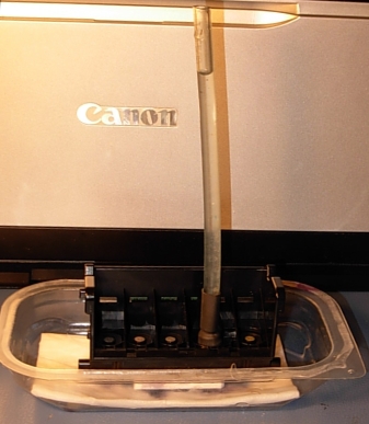

I then tried to unclog the yellow channel by attaching a short plastic tube to the yellow ink inlet and fill it with a window cleaner with ammonia. The printhead was placed in a tray on a tissue paper wetted with the same window cleaner. Like this, click to enlarge:

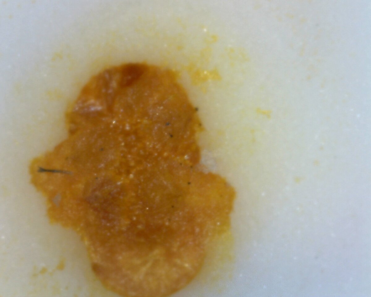

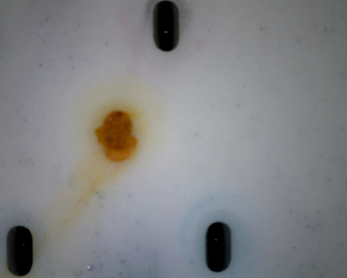

I left this for a couple of days. but the liquid didn't drop in the tube and the printhead was still clogged. I then placed the tray and printhead in a couple of centimetres or one inch of water in a frying pan and heated the water to almost boiling for an hour. The yellow was still clogged. I then disassembled the printhead by removing the ceramic plate.
Both the yellow channel in the upper plastic part and in the ceramic plate was totally clogged by dried yellow ink.

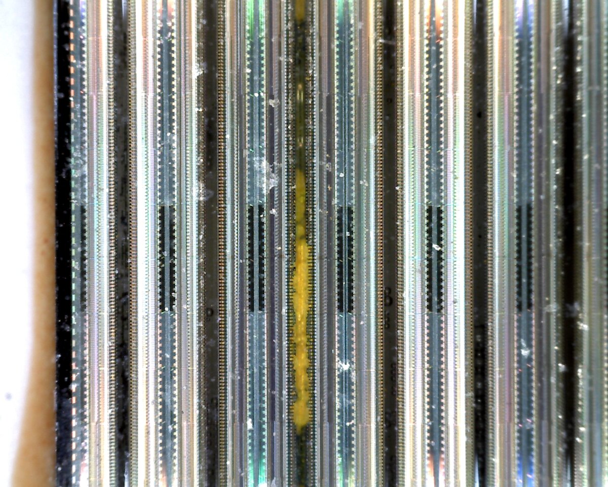

Here is the ceramic plate in 50 x magnification, click to enlarge:
And here in 250 x magnification, click to enlarge:

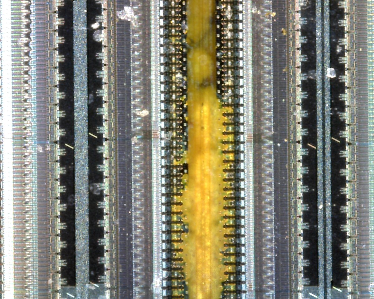

Here are the yellow nozzles in 50 x magnification, click to enlarge:
And here they are in 250 x magnification, click to enlarge:
This shows that refilling using a wrong or bad ink and/or wrong procedure can quickly ruin a printer. I kept the cartridges and dumped the printer.
Edit: I think the clog was caused by the "Yellow gello".
