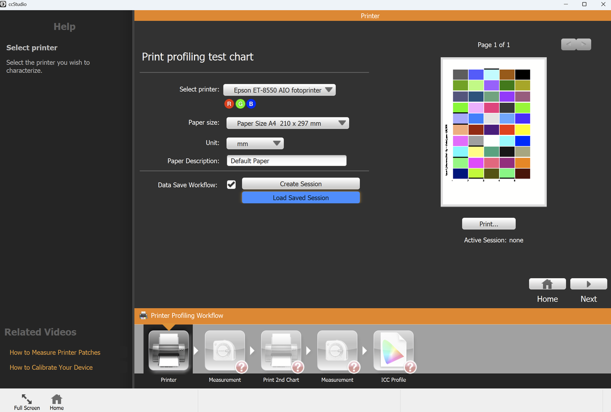

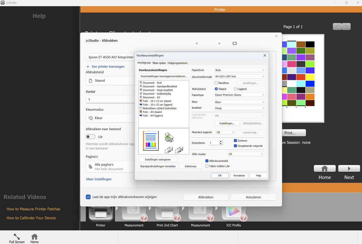

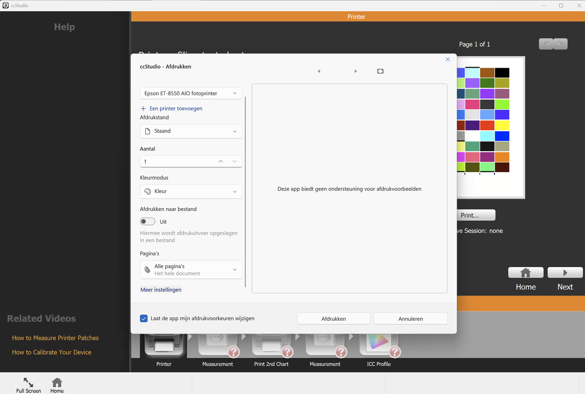

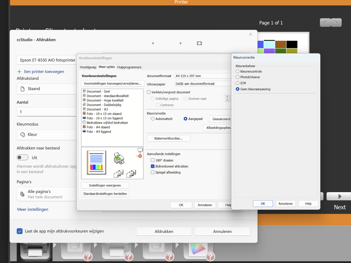

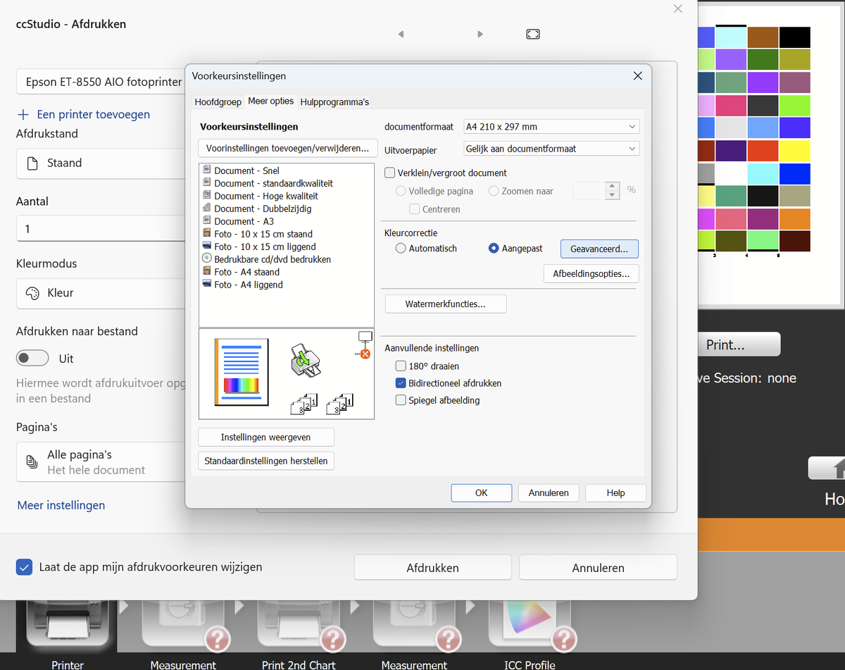

May I ask what do you actually want: you seem to drag everything that is not is not the point of your problem ??? What has the 5090 to do with your printer (unless your screen is badly profiled). We know that updating firmware is not good for using aftermarket inks/cartridges and why mentioning Jone Cone in this discussion: it doesnt seems to make any sense in specifying and solving your problem....I presume you have tried my Windows 11 based method to print your i1Studio/ccStudio target with help of my step by step print screens to obtain a good profile. I have Windows 11 too and not the slightest problems you are mentioning here.
