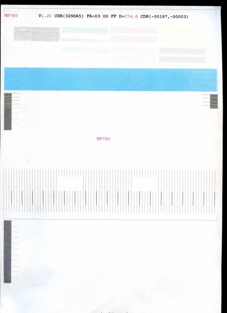

Here are some images: couldn't seem to post actual images, just the links (sorry!)
http://www.nifty-stuff.com/forum/uploads/5533_mp780_test_pg030.jpg
This one shows test colour copy before print head clean.

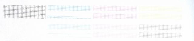

http://www.nifty-stuff.com/forum/uploads/5533_mp780_std027.jpg
Standard print head test post clean

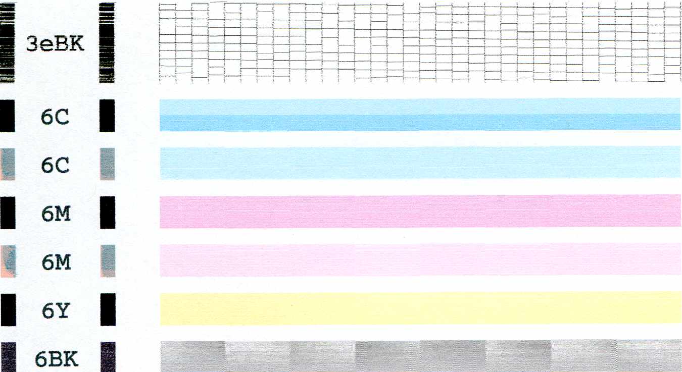

http://www.nifty-stuff.com/forum/uploads/5533_mp780_extd028.jpg
extended test - post clean
Is print head needing replaced, or would it be worth trying to clean with window cleaner? Is it ammonia based cleaner I need - the kind for window and glass?

Your nozzle checks show that you have an electrical problem on the upper cyan set of nozzles. The upper half is not printing fully. This cannot be fixed except by buying a new print head. You can still try to clean the print head using Windex or other window cleaner, preferably with ammonia but if you are located in a country that bans ammonia then just use any window cleaner. If you ever remove the print head from the printer to clean it, make sure you let it sit for two days in a warm spot for it to dry before returning it to the printer or you can risk damaging both the print head and the printer.

The sensible way to go is to get a new print head. You cannot fix your cyan problem with cleanings and you run the risk of damaging your printer by cleaning the print head outside the printer unless you wait two days for it to dry, which it sounds like you are doing. Still, when you do cleanings inside the printer, you are just making the day come earlier when you will have to replace the waste ink absorber pads.
I also do not recommend using alcohol, you run the risk of damaging the seals inside the print head that keeps the colors separate. Window cleaner or just plain water will work just fine.
