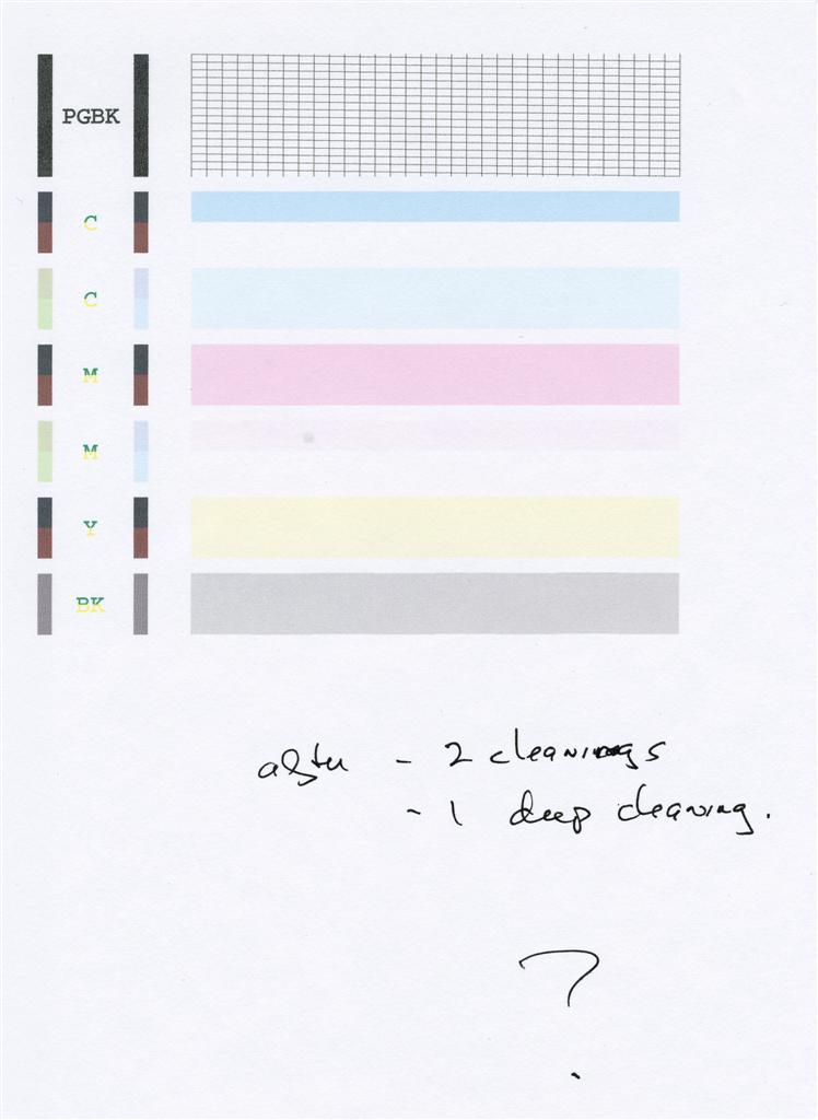

print mainly BLACK here, but tried some color printing and the colors came out off. did nozzle checks, before and after 2 cleanings and 1 deep cleaning, all nozzle checks came out the same. sigh.....
see below for nozzle check scan
any ideas ?

I think there must be something in the air lately because you are the third or fourth guy
in the past week or so that has the same issues.
Your nozzle check suggests an electrical problem and a new print head may be required to get you back printing again properly.
I would strongly suggest that you do a nozzle check at least weekly to keep your colours in good condition when not in use.

thx for the quick reply Hat !
looked electrical to me, but wanted a second set of eyes before i started to unclog
print head is like 18 months old, 20,000 pages on it, might be gremlins....

here's another scan

had a spare print head, put it in and now all is good !
BTW, can still get new print heads from canon, MP830 was $49 shipped +tax, about 50% of what was on amazon/ebay
