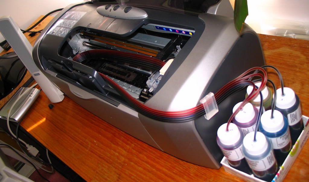

Here's some shots of so called Homebrew DIY KISS CISS Systems.
If you don't already know these systems are by far the most reliable especially for pigment ink based Epson printers. They simply outperform the commercial offerings because they are highly functional, extremely serviceable, and the quality of the product is as high as you want to put into it.
KISS because they are that simple with no marketing excrement.

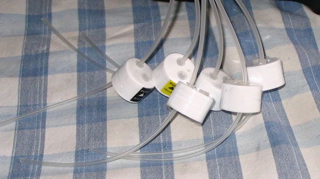

Then some MAGIC Caps with at least two holes: one for the tubes and one to let air in.

Then you prepare the other ends to go into the magic caps
Here's how the Tanks will look like with the caps, Just drop the tubes in to the bottom:
Here's how the caps fit into the bottles:
Here's an R200 completed
That's pretty much all there is to a CISS system. If the cartridges are full no priming is really necessary, as the ink is used the ink will move into the cartridges.

Just a couple of things to add that may not be immediately obvious to some or simply fallen out of the common knowledge pool due to all the commercial CIS offerings now.
1. Ink levels in the bottles should never be above the level of the cartridges in the printer (preferably 1cm or so below). Overpressure results if you don't pay attention.
2. You may want to consider getting some tube clamps if you intend to move the CIS+printer around as this stops issues of ink pushing and pulling during movement. Such movement forces ink out or air ink through the nozzles so best avoided.
For the homebrew approach though, folding the tubing to form a kink works just fine too.
3. For pigment ink systems, make sure you swill the ink bottles regularly and also ensure that the dip part of the tube doesn't go all the way to the bottom of the bottle... Allow a 5mm+ gap to allow any sediment settling to lie further down from the tube, so you don't get an over-concentration of pigment. This is especially true of Magenta in Durabrite inks for some reason...

I would like to add my two pence worth in your design:- you could add a rubber collar to the tubing where it enters the bottle top which would stop the tubing travelling down to low into the bottle.

The rubber collars are there if you look carefully. This prevents ink from coming out if the tanks are moved around. So I've already covered that. The user can also add ink fill inlets are required using my Canon plugs as shown on one of the pictures. A good seal for the breather hole is a toothpick. Finally if the user wants they can add breather filters as well.
BTW, essentially the same system has been in existence for over 10 years at a reputable store that have proven the desiign. The only difference is that their system is really costly. I will market the components to customers who have already purchased refillable cartridge they are happy with and it will cost them $10 plus shipping. A reasonable amount so that they can transform their systems into a first class problem free CISS. Again the quality of the system will be based on what the installer puts into it. For the nominal sum they will get around 4 to 5 feet of 8 channel tubing, 18 collars, 9 elbows, a tee support, tubing suppost and a clinch bar for the cartridges. This will allow refitting of systems from R2400s to as small as 4 cartridge Epsons.
I decided on using nylon ties for the R200 as that is permanent and will never come off. The side feed on the tubes is also used on my RX580 and with this the tubes never slap and make no noise at all making for a mechanically stress free installation ensuring long term reliability.
