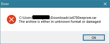

Hello guys. I have a Canon IX6780 printer works good until a few days ago. Code 1700 appears and I used reset software to clear the wastepad count but I forgot to place a paper to print after the waste pad count resetting process. In stead I just pressed the power button to power off the printer. And then I cannot power on the printer again. I tried to press and hold power button and stop button to hard reset but in vain. I took out the motherboard and dumped the eeprom with CH341A programmer but I don't know which part should I modify to make it work again. The printer eeprom dump attached below, it seems corrupted during the resetting process. Anyone here familiar with this situation and knowledge of this issue? Any help would be appreciated.

Win Rar cannot open the archive. 7 Zip and Total Commander also fail to open it.
