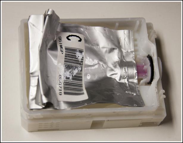

I had an very low Magenta cart on my R3800 I had to replace it.
I now had an empty Magenta cart that I sould not wait to perform surgery on.
All went well and no mess at all.
I removed the paper label and pried off the cover facing the film covering the side of the cart.
To my surprise I found an ink bag directly attached to a the ink outlet port.
I carefully cut out the plastic film and took off a plastic webbed piece that held the ink bag down and in place.
The following images show what it all looks like.
As you can see from these pictures, the internal structure of these carts is rediculously simple yet brilliant!
I actually attemted to inject water into the exit port and though it took a lot of fiddling, I was able to do it with a syringe. The tip of the typical syringe is too large in diameter and though I was able to inject water into it, it was not easy to do so. You would need a custom designed tip that would dpress the exit port valve and at the same time seal itself within the port rubber gasket.
So If this is possible and a resetter was available, you ought to be able to reuse OEM carts and OEM chips and refill them with any of the several good inks available out there. By the way, there is no "Wet Sensor" behind these chips like are found in other Epson carts so that would not be a problem to contend with.

You can make up a little cap like (the freedom refiller) that will fit over the inlet port to hold open the valve and then fit the syringe on that.
In the mean time a resetter or ARC chips shouldnt take that long to hit the market so you can use that time to perfect a new refiller.
If these cartridges will work with the chip disabled then youre onto a winner..:thumbsup

the problem is the one-way valve: it is possible to suck ink from the cartridge, but I never was able to inject the ink into these cartridges. So if someone could tell me how to deal with it, many thanks !!!
15,840
8,871
I am sure that a replica of the print head layout could be made and glued up together,
then pressed against the cartridge to hold the valve open allowing free access to the inner bag.
Anyone want to send me a photo of the print head and a cartridge to experiment with ? :woot

Late last night, now that I had the bag and oulet port / valve in hand I was able to force water into the bag with a 10ml syringe. The problem is, like TheHat suggested, is an adapter that will push the valve open, thus oppening and allowing access to injecting fluid into the bag. Because I only have two hands, I clamped the bag lightly by the plastic port assembly ( Refer to photos ) on a small vice to provide support and was able to inject about 20 ml of water into the bag. The hardest part is getting the poppet valve to remain open and at the same time provide enough of a seal so you do not leak ink all over the place as it appears to take a bit of pressure to push the fluid into the bag. Another problem is that a syring tip, though it can push open the poppet valve, also seals itself against it. So when you apply pressure on the syringe, it takes quite a bit more pressure to force ink around it and into the bag. The poppet remains in really good contact against the end of the syringe tip. I need to figure out how to push open the poppet and keep it open while at the same tine pushing ink into the bag.

Thank you Tudor but I didn't know I had the solution right in my shop.
I had recently purchased an Epson refilling tool kit, Epson Super Valve Plug Kit 3233 from R-Jet Tek
http://www.rjettek.com/s.nl/sc.7/category./.f?search=3233
and as part of all the tools it came with exactly the adapter you would need.
It has a Luer lock back and as you can see the tip has been modified to allow the poppet to be pushed in while allowing free flow of fluid.
Apparently these valves aren't really "One Way"

Well, even though I was originally able to inject almost 70 ml of water into the bag, That is no longer the case. I cannot for the life of me inject any more water into the valve.
Mind boggling!!!
Anyway It was a fun thought!!
