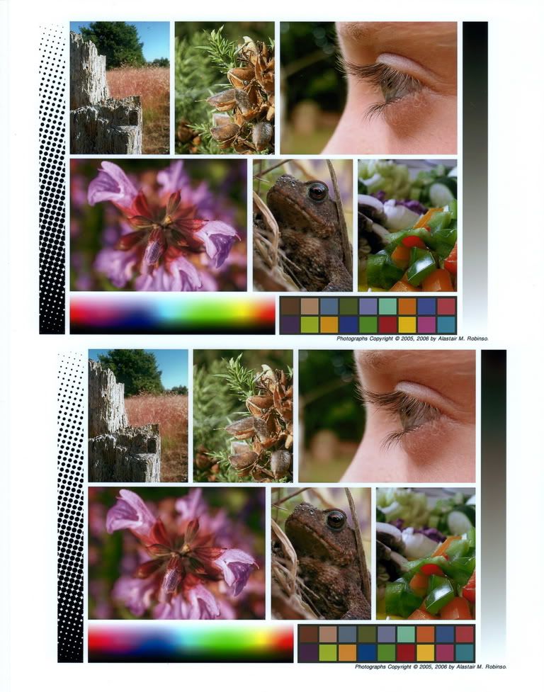

This is a comparison between two images. One was created using a custom ICC profile. The other was printed using the standard driver with NO COLOR MANAGEMENT. Remember the standard driver was meant to use dye ink but I am able to get around this aspect to a large degree. So the printer is using a pigment inkset totally foreign to its original design.
Which one is the profiled one? Is it close enough to allow novices to create archival photos with any application?

I'd say it's close enough, I've seen photo labs that were more off than that. Although the second one looks like a better color rendition so I'd guess the second is profiled.
