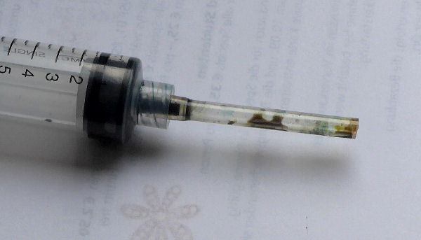

I'm using a cleaning tool for the reverse sucking method as per attached image,
I loosen the printhead carriage and move it into a convenient position and place a folded piece of household paper unterneath as it fits, I fill the syringe with 3 ml cleaner, place the tube over the ink pickup rod, pull first and see some ink coming, then bubbles, I push the cleaner back in, this cycle about 3 times, and then - if any cleaner got into the bottom of the carriage -I pick up the cleaner from there with the syringe as the last clean up step. With the cartridges fitted again I run a cleaning cyle and a nozzle check. I just yesterday got a R265 working again with this approach which was idling for quite some time. I do that procedure almost directly if a cleaning cycle does not help, I'm using less ink that way. Cleaning Tool.jpg
I loosen the printhead carriage and move it into a convenient position and place a folded piece of household paper unterneath as it fits, I fill the syringe with 3 ml cleaner, place the tube over the ink pickup rod, pull first and see some ink coming, then bubbles, I push the cleaner back in, this cycle about 3 times, and then - if any cleaner got into the bottom of the carriage -I pick up the cleaner from there with the syringe as the last clean up step. With the cartridges fitted again I run a cleaning cyle and a nozzle check. I just yesterday got a R265 working again with this approach which was idling for quite some time. I do that procedure almost directly if a cleaning cycle does not help, I'm using less ink that way. View attachment 3284

When you write to loosen the printhead carriage what do you mean?
I want to sure to have understood the method. Do you pull and push ink/cleaner from nozzle?
I didn't loosen the printhead carriage and I don't know how can I do..
You fit a piece of paper at the bottom to avoid the liquid sprinkling?

W'ICReset - just instal it and check whether the routine recognizes your printer, you can make readouts - status - waste ink counter
Power on the printer, the head starts moving away from the cleaning unit, idle positiion, and pull the power cable quickly to interrupt this startup sequence, and now you can freely move the printhead carriage left and right into any convenient position
First pull the syringe to suck ink out of the ink channel, then push some cleaning fluid back in, the pull/push again
