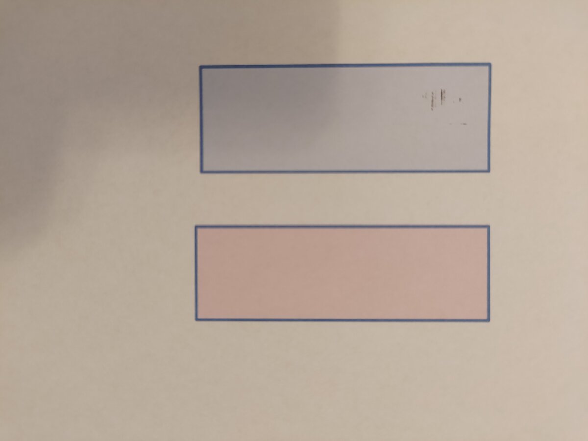

Hi
"I have a problem with my Canon i9950 printer. Before printing a photo, I do a nozzle check and it's fine. However, during printing, the output gets banding, striped, and the nozzles become clogged. When I check the nozzle again, I find that the Photo cyan and/ or Photo magenta has some clogged nozzles. To troubleshoot, I print some small rectangles with cyan and magenta on photo paper and perform nozzle checks, which yields better results each time. After I get good nozzle check and start print photo again, I get the same issue with clogged nozzles during printing. Even after running the cleaning cycle in maintenance, the nozzle check pattern worsens."
I using only orginal Canon inks 6. And i change new ones PM and PC always same problem.
Saphire
Feb 4, 2014
64
61
68
Split Croatia
Canon i9950

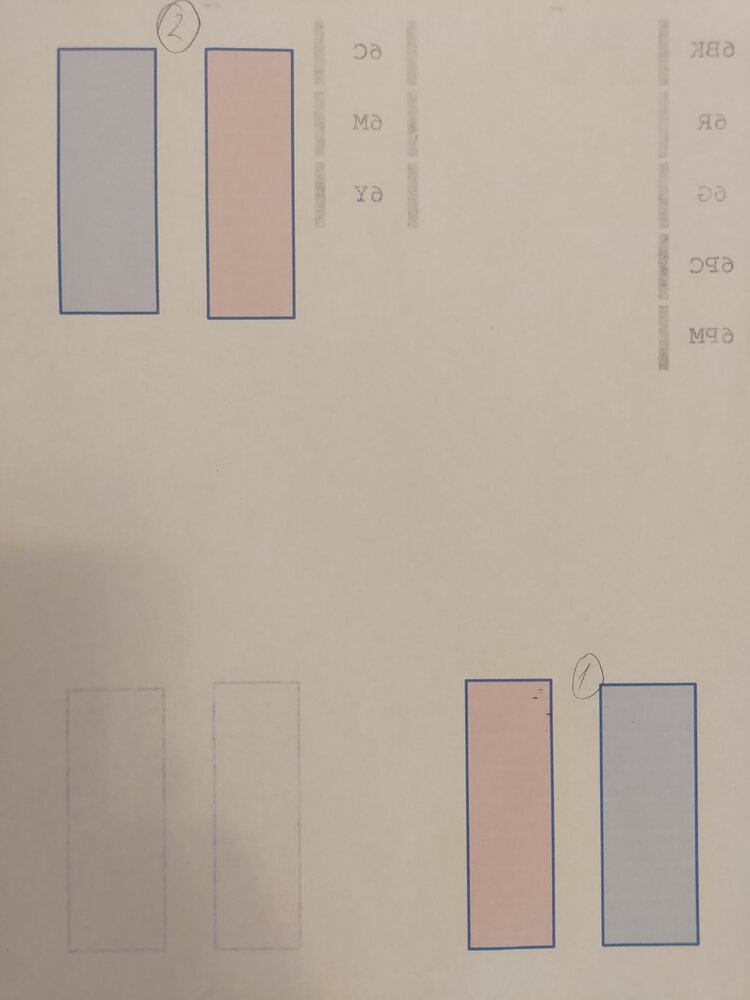

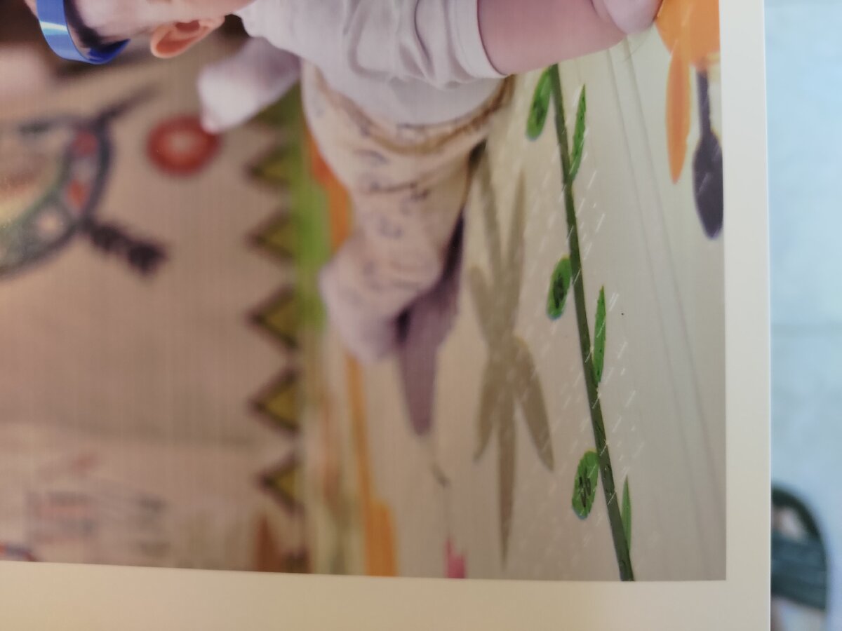

Here are the bandigs in first picture, second picture is printed recentagles(attempt1 and atempt2) just after photo1. and third picture is printed recentagles after 5 attempts. black strikes are because I unchecked paper abrasion.
same thing with nozzle check.

The Hat is open mine eyes. I think is the purge unit problem. Now things getting even worse.
One pad soak water immediately and another is like pool. I have problems only when printing the photos.
I had same defect years ago on another printer. So now i will do same thing on this
Post in thread 'micro banding' https://www.printerknowledge.com/threads/micro-banding.9038/post-74395
Also first printer is still alive, only it can't feed paper properly.
Saphire
Feb 4, 2014
64
61
68
Split Croatia
Canon i9950
"Yes, it was loose hoses in the purge unit. The head is in perfect condition. I printed a picture finally without bandings. Thanks for the help and replies."
